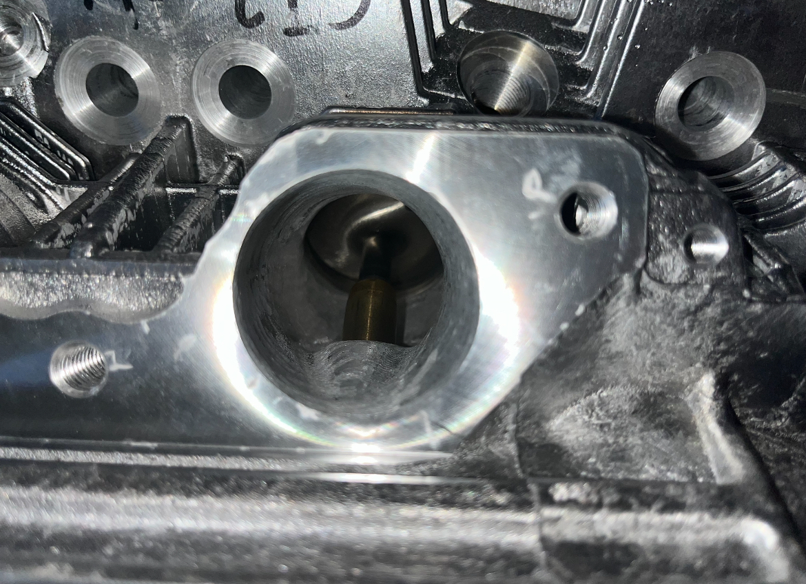

I moved this from the Paddock, thought I put it here. Because the port is almost straight, with little long side short side turns, with what there is , do you find it necessary to slow the flow down on the “short side” to get good flow out of the valve. I was reading about something mepstein posted a picture of. Small divots, like a golf ball. So I’m going to do that on the long side, just wondering if there is any reason not to also do it on the short side. Thanks guy’s smile.gif

Caveat - these are the 2.0L AA Chinese head casting re-done by HAM.
I didn’t pay for any sort of elaborate porting. Exhaust looks pretty stock. Intake has been worked a little bit - probably to remove casting flash and/or smooth out a little but certainly aren’t polished or anything like that - nor did I pay for or expect that.

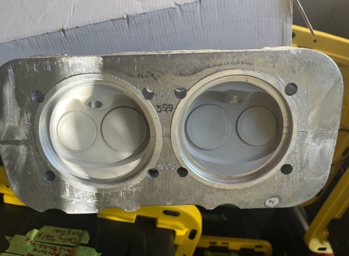

burton73   @Shivers Just so you can see the HAM RAT head on ...   Sep 9 2024, 11:29 AM

rfinegan   @burton73 can you post a pick or 2 of the chamber...   Sep 9 2024, 12:14 PM
burton73   [b]@[url=http://www.914world.com/bbs2/index.php?s...   Sep 9 2024, 06:05 PM

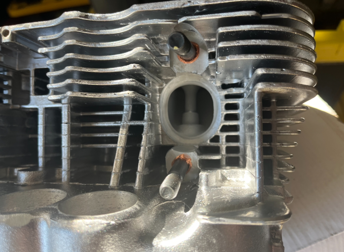

914werke   Bob do you have pics of the exhaust?   Sep 9 2024, 12:17 PM
Superhawk996   Take a look at this thread and exhaust port cutawa...   Sep 9 2024, 12:36 PM

rfinegan   @burton73 Thanks for the pics of the 2.0 chambers...   Sep 12 2024, 04:22 PM
