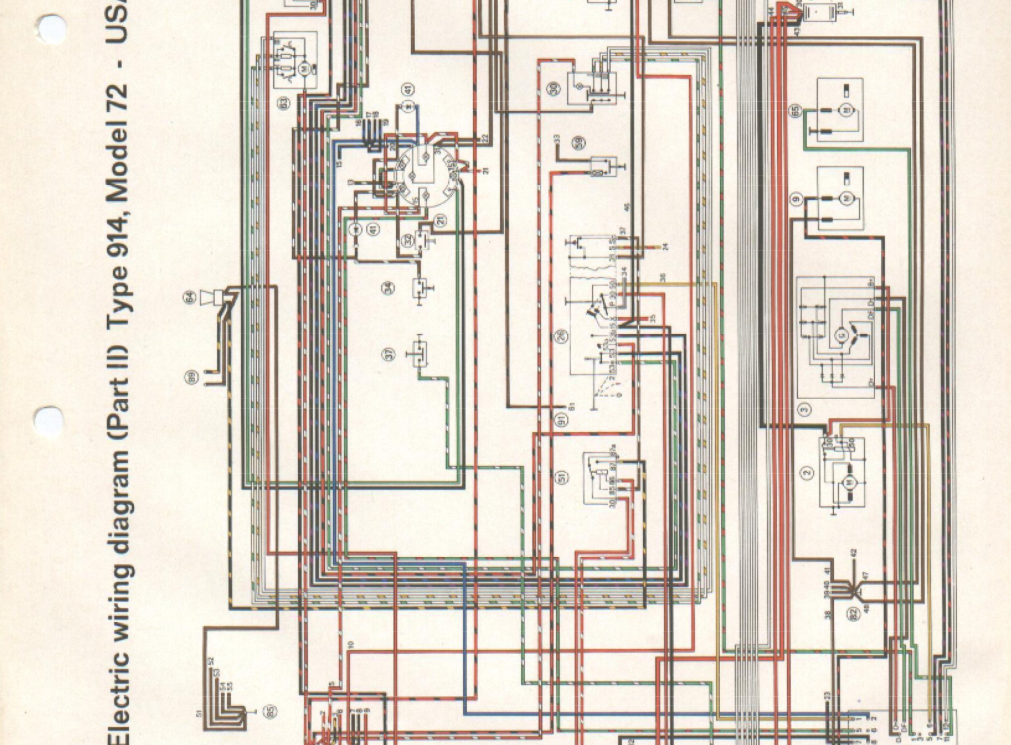

Link to Workshop Manual #8 Electrical
@paIsa
Try Pages 26 & 27 item #32

Ishley   I have a 72... and I went out to my shop and looke...   Sep 13 2024, 09:39 PM
Ishley   It's item 34 on the wiring diagram.   Sep 13 2024, 09:45 PM
