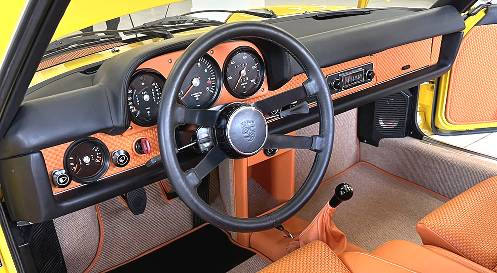

This is a real early 911 horn button on my 6. To get it to look like this, you need the good leather and some padding behind it. Fully restored on chrome and plastic by PMB
Best Bob B

That picture gives me a good idea of the diameter compared to the wheel. I thought mine was a little narrow but I looks like there is a visible edge on the wheel under the puck.

Yes, it needs a bit of room so it can function as a horn button. It’s doing the same thing as a batwing and moving a bit to make contact for the horn to work
