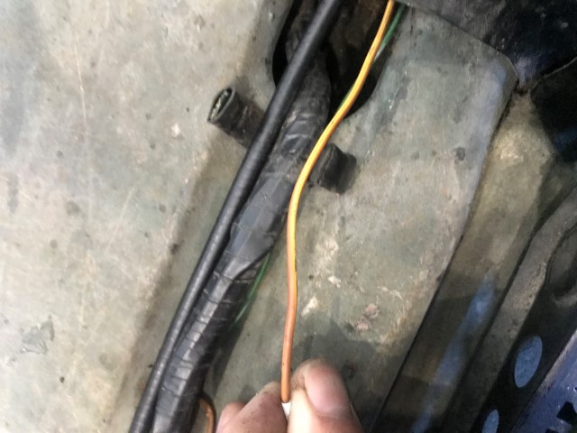

..The original wire seems to be brown-yellow, although I would have thought it would be brown-white. In the image blow, we see the wire going to the E-brake switch (yellow wire running behind were should be the driver seat. The tie-in to the original wire is where there is white electrical tape.
That's interesting.. when you raised the question regarding the ebrake lever's wiring - I immediately thought 'that is a Brown/Yellow wire' (I recently went thru and installed my entire '72 harness).. then I looked at the diagram that was posted and it shows to be BR/WH. Now you say it's Brown/Yellow so I was correct on that.. wonder why the diagram chart is showing different (IMG:style_emoticons/default/idea.gif)
-Anyway, there is a Diode behind the combo gauge that tie these items together (combo gauge/Seatbelt warning/Ebrake) - perhaps that diode is bad. But it's usually the simple things - I think you may be getting a flashing light because you have the seat belt warning lines disconnected. Why are they disconnected anyway?

Just confirm the wire color: it is Brown-Yellow (see photo). I am pretty sure it is the original wire.
