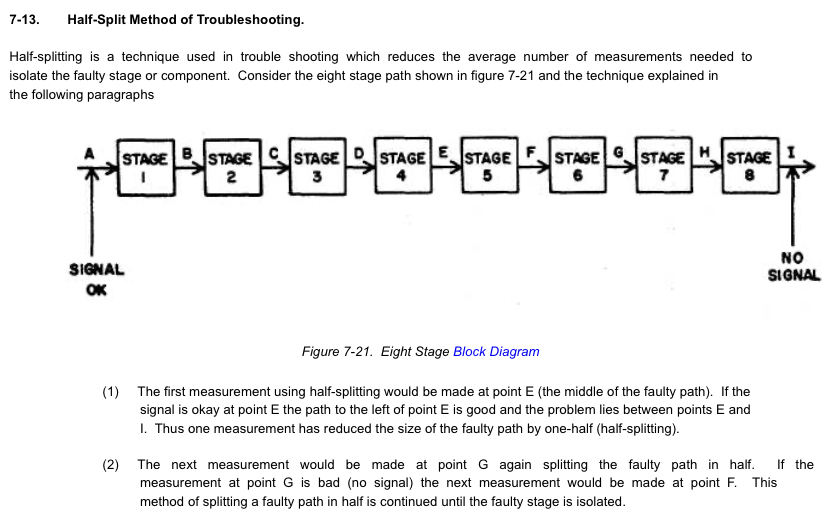

It sounds like you are open to some coaching on what you could have done.
Methodical troubleshooting with a DMM and/or test lamp probably would have gotten you to your event. Throwing parts at problems and remove & replace “testing” is rarely the most time effective solution. For whatever reason, this is a really popular thing for hobbyist’s to do so in no way is this a critique of you personally. Easier said than done when you’re under pressure I know. I was trained by USAF as an electronics tech and it was repeatedly drilled that methodical troubleshooting using the half-split method IS the fastest way to solve a problem - especially so when under pressure. We were often tested under the clock with problems that were intentionally designed to mislead. It was repeatedly proven to me that methodical half-split troubleshooting is the fastest approach. Remove and replace testing often induces new problems and alters symptoms that will simply run you in circles. Advice worth what you paid for it, or double your money back. (IMG:style_emoticons/default/beerchug.gif) |

methodical troubleshooting using the half-split method IS the fastest way to solve a problem I think you have volunteered to write an article on the half-split method... (IMG:style_emoticons/default/smash.gif) |

methodical troubleshooting using the half-split method IS the fastest way to solve a problem I think you have volunteered to write an article on the half-split method... (IMG:style_emoticons/default/smash.gif) It’s very well documented. Google will get you there. ![]() The example above implies we are troubleshooting an electrical signal but the concept is just as easily applied to mechanical devices like an engine. Here is another explanation that is good and touches on how use of half-splitting works. Using half splitting you can determine the a particular card drawn from a deck of 52 cards with only six questions. https://www.ecmweb.com/maintenance-repair-o...-half-splitting |
