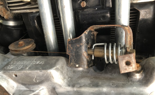

I bought my project car several years back - came with its original 1.7L that had been freshly rebuilt but not installed yet. I noticed this thermostat that was on it when I got it and basically ignored it til now.. it looks a little different than the originals- anyone know the specifics on it?

I am not finding this spring style 914 T-stat on the Awesome Powdercoat site, maybe they are NLA? Only the conventional design.
The only other 914 T-stat I know of from Classic Steel Body and it is also the conventional design

mgphoto   Seen it on the samba, aftermarket, supposed to wor...   Sep 19 2024, 09:02 PM
wonkipop   thermally expanding spring. its the KISS principle...   Sep 20 2024, 04:27 AM
jvmarino   That is the newer style t-stats that are sold by V...   Sep 20 2024, 08:16 AM
Literati914   So the picture I posted is a cold engine.. and the...   Sep 20 2024, 08:43 AM
jvmarino   So the picture I posted is a cold engine.. and th...   Sep 20 2024, 01:20 PM
porschetub   So the picture I posted is a cold engine.. and t...   Sep 20 2024, 10:27 PM

wonkipop   ah i see is the shaft inside the spring a piston f...   Sep 20 2024, 03:14 PM
porschetub   ah i see is the shaft inside the spring a piston ...   Sep 23 2024, 01:35 PM
JeffBowlsby   Looks like they are Dansk units. Found them liste...   Sep 20 2024, 03:24 PM
