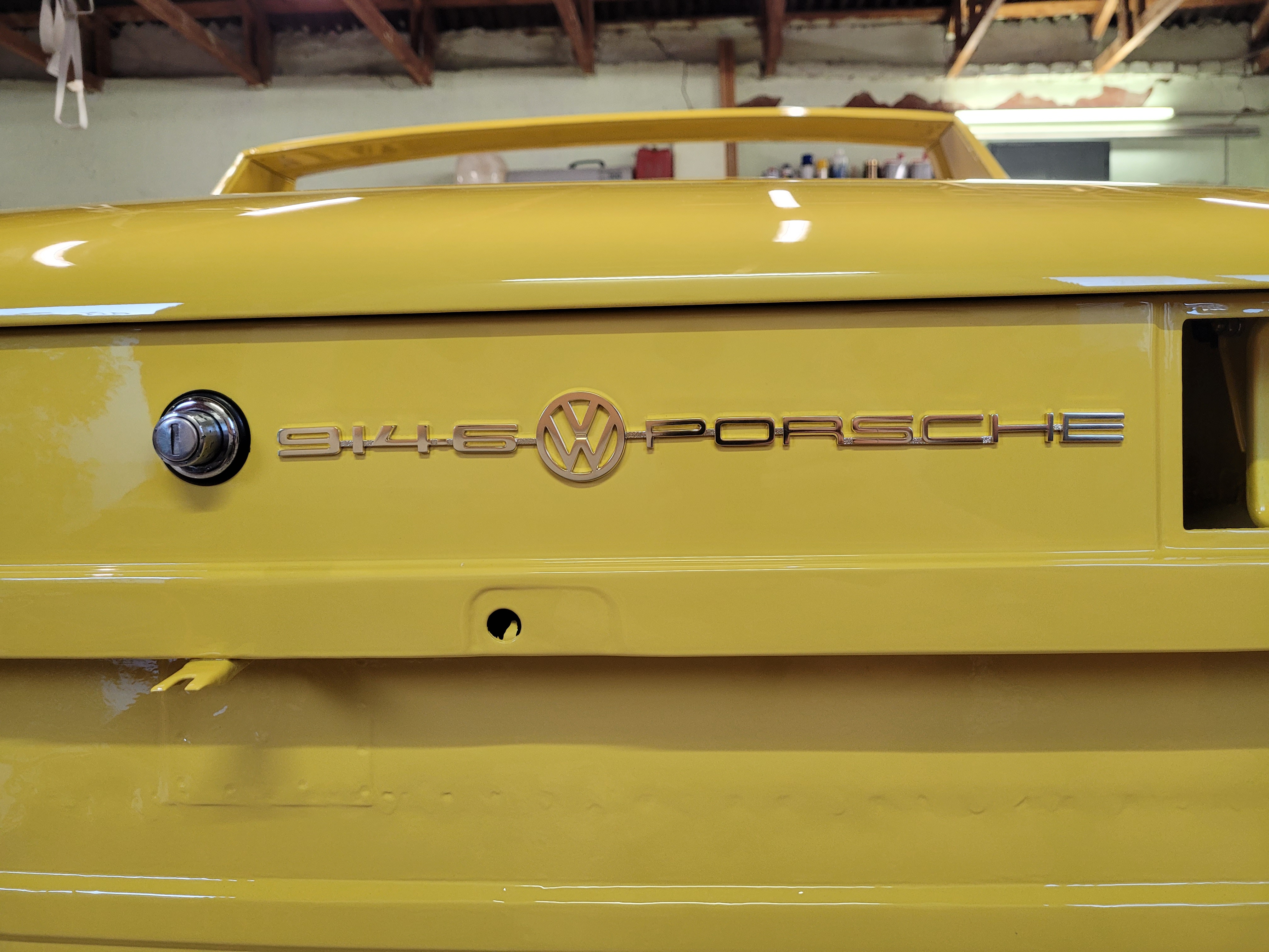

914Gelb   Slowly I proceed with the rebuild of my car, there...   Sep 24 2024, 11:29 PM
914Gelb   The paint is single stage from glasuit, look at...   Sep 24 2024, 11:32 PM
914Gelb   RE: Any idea how to solve bad door clearence   Sep 24 2024, 11:34 PM
914Gelb   RE: Any idea how to solve bad door clearence   Sep 24 2024, 11:35 PM
914Gelb   RE: Any idea how to solve bad door clearence   Sep 24 2024, 11:37 PM
914Gelb   RE: Any idea how to solve bad door clearence   Sep 24 2024, 11:38 PM
914Gelb   RE: Any idea how to solve bad door clearence   Sep 24 2024, 11:40 PM
914Gelb   RE: Any idea how to solve bad door clearence   Sep 24 2024, 11:41 PM
914Gelb   RE: Any idea how to solve bad door clearence   Sep 24 2024, 11:43 PM
914Gelb   RE: Any idea how to solve bad door clearence   Sep 24 2024, 11:45 PM
914Gelb   RE: Any idea how to solve bad door clearence   Sep 24 2024, 11:46 PM
