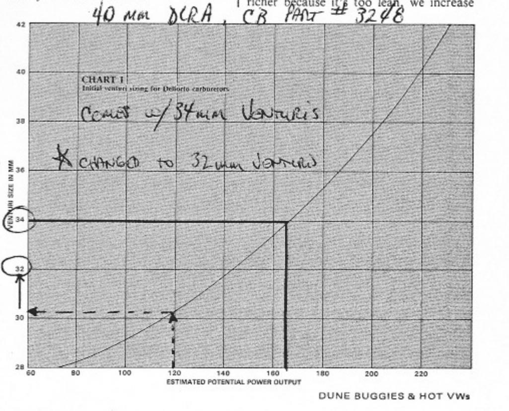

You may find this chart helpful too:
As you can see, I over-estimated power and Venturi size. With 32mm vents the car bogged off-idle (WOT was good though). Switching to 30mm vents got rid of the off-idle bog, while providing very good performance across the rpm range.
For context, the engine is 2.0 with an Elgin cam (7008-4/2L, 280* duration) and Mahle Euro piston and cylinder set. Carbs are set up with 30mm main venturis, 55 idle jets, 135 main jets, 180 air correction jets, and 9164.2 emulsion tubes. Car runs great here at sea-level.
When I was stationed in Colorado Springs, I think I kept the 30mm vents, but dropped at least one size on the idle and main jets. I'll see if I have any notes.
Hope this helps!
