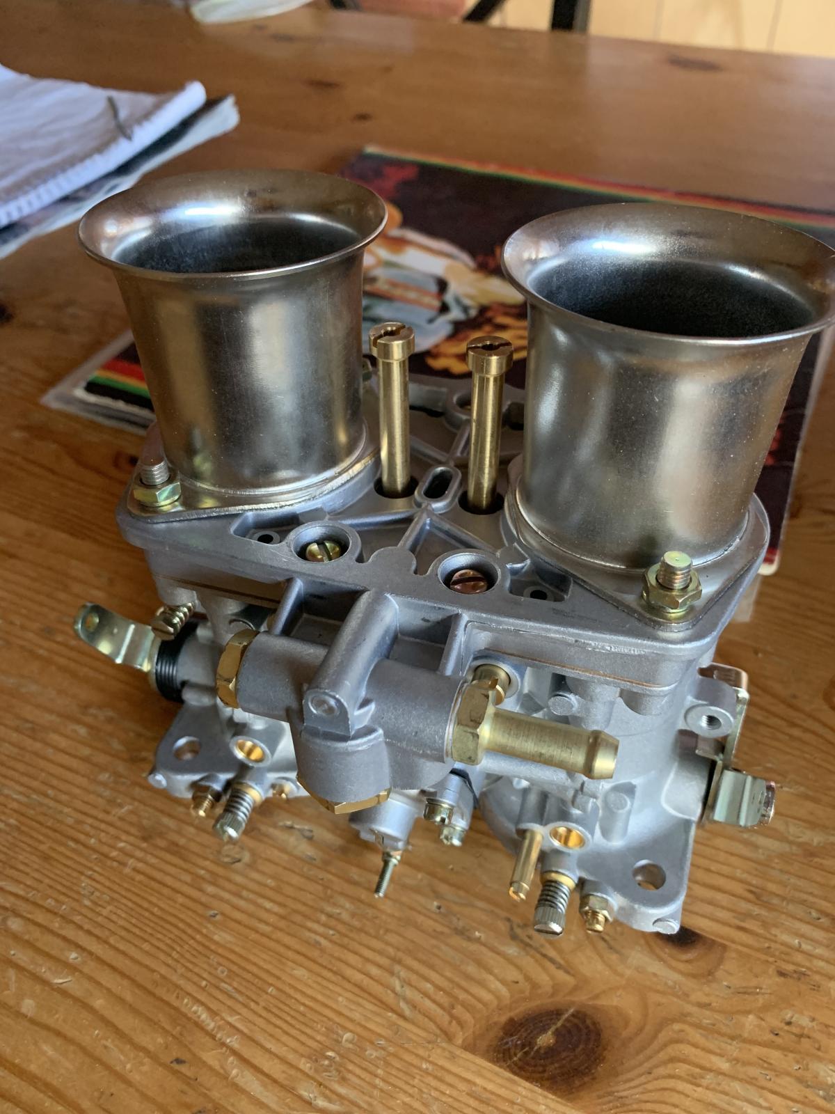

Here's a couple pics of the carbs:

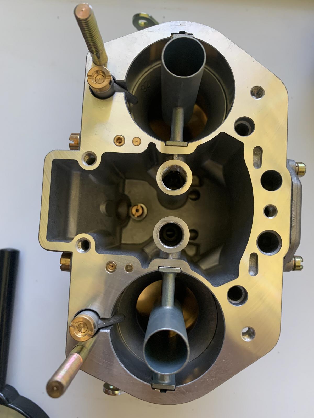

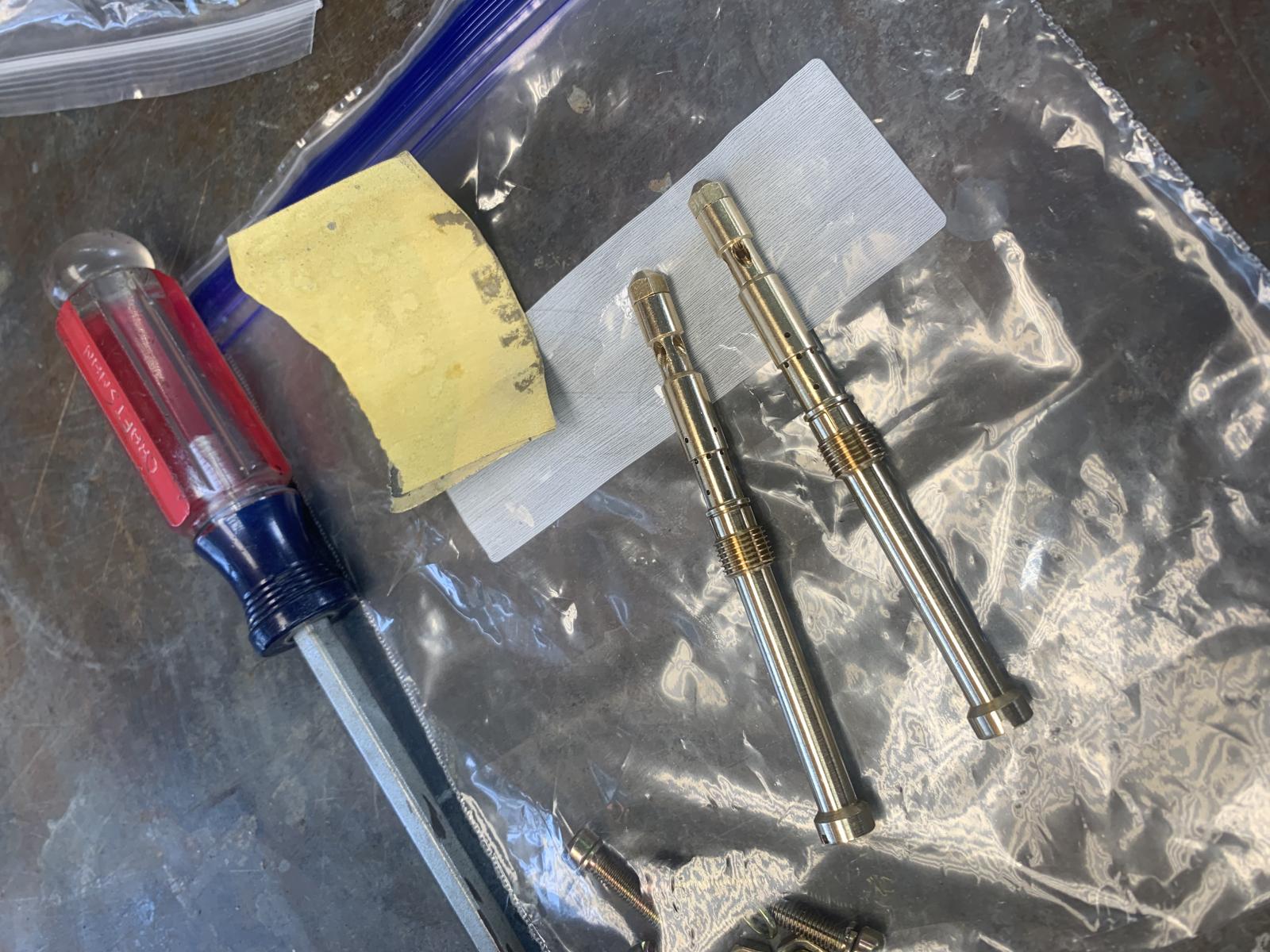

One other issue which I failed to mention, is that the jets and emulsion tubes were very tight. I ended up cleaning up the sealing surfaces with some fine sandpaper and now things fit nicely.

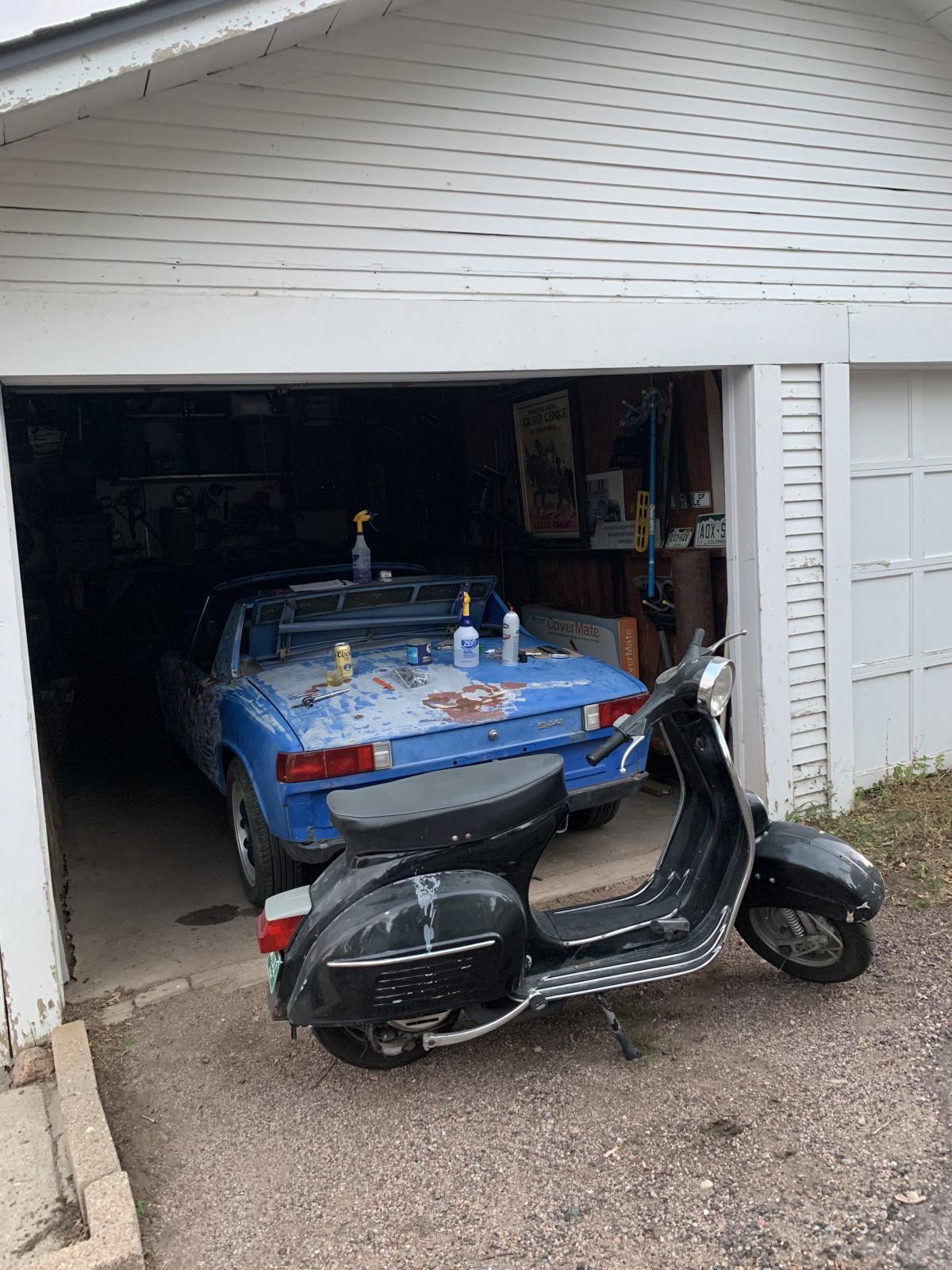

I'm working in some pretty primitive circumstances with minimal tools, at my house. I wanted a project to tinker on at the house. I'll move it to my shop once it's rolling.
