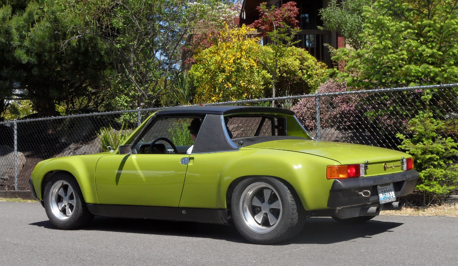

Backing the day you could buy a actual 245/50 -15 ,, that tire on 9s was tough fit with factory GT flairs, Erics GT can barely run 15x8s ,,,
So results canvary a bunch, my GT has has 15x9s and 245/50 -15s with lip rolled up.. Attached image(s)
