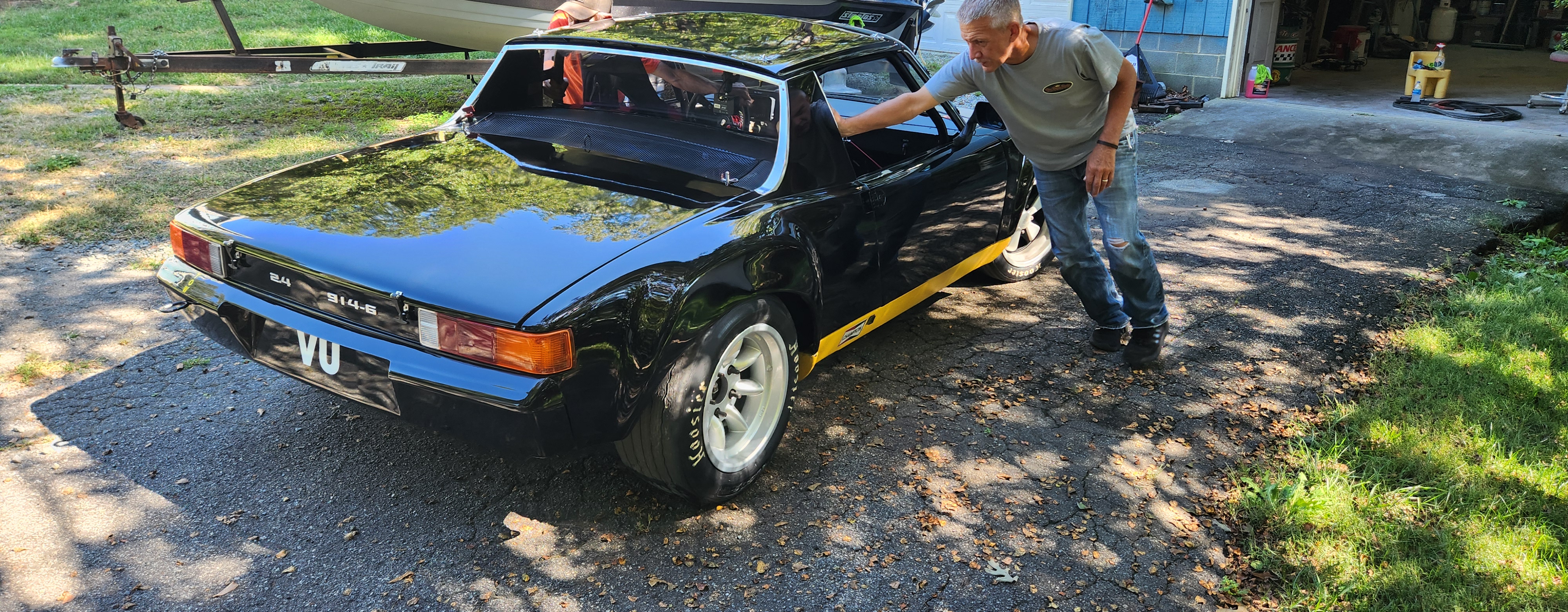

One of my combos is 15x9 and I used minilites from AircooledRacing.net. Steve has departed us but I think his shop lives on and may still be the US distributor for them. It is also period correct as the factory used them due to a fuch not being made that large in 1970. Mine fit great under my flares but it doesn't mean it will work for yours. All seem to.vary a bit.
Attached thumbnail(s) |
