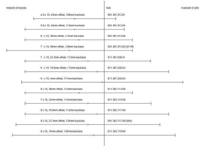

I am going to order some new wheels for my track car. 15 x 9. I understand backspacing. I think all 911 and 914/6 backspacing stock is 125mm. That is what I'd like. The manufacturer is listing three different ETs: 3mm, 10.6, 23.3. Which ET gives me the stock backspacing?

This chart may be some help.
It is for 911 Fuchs offsets ![]() |

sixnotfour A factory 15x9 is 3mm offset,and have a 117mm back... Oct 9 2024, 08:38 AM
Krieger Thank you! So a 9" rim =228.6. 228.6/2... Oct 9 2024, 08:39 AM
