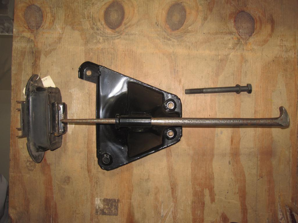

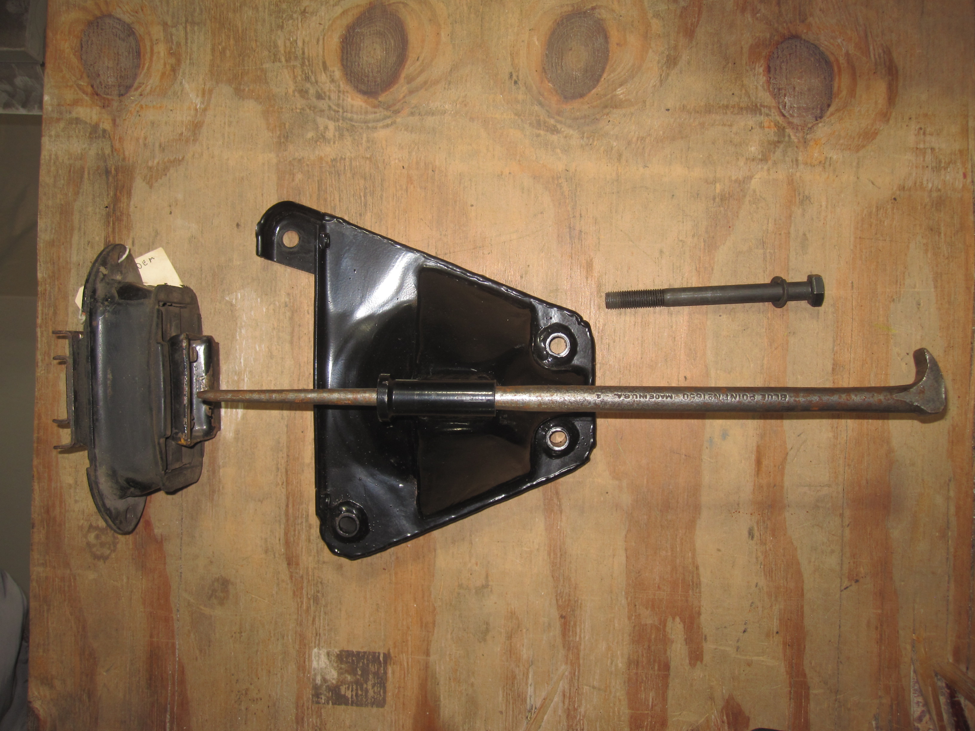

A 911 engine can be removed and installed one handed and blindfolded on a floor jack.
A 914 6 is always a challenge.
One tool that I've found to be very helpful especially with a stock 914 6 front mount
is a long drift pin.
Might be helpful with your front mount as well Tom
