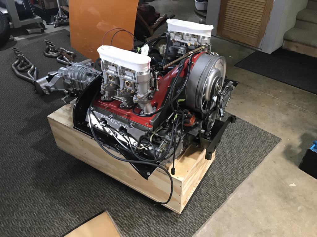

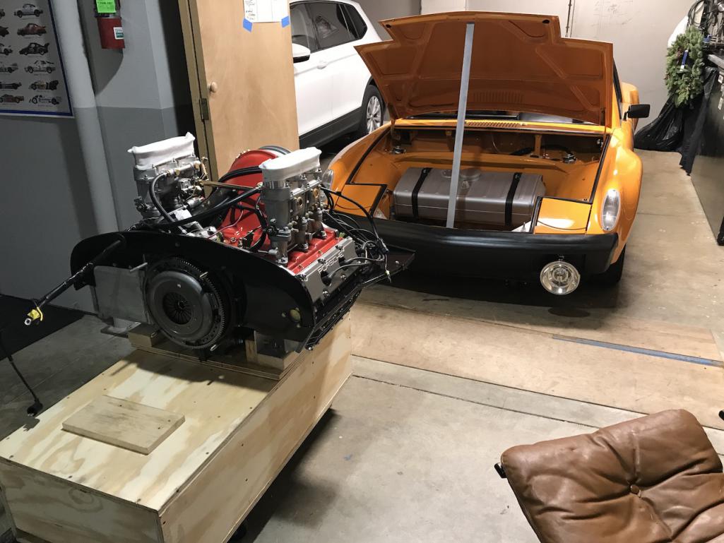

My engine install was with a scissor lift. Had to build a box for the engine/trans to set on. rolled under car and lowered the lift. Worked really well but also had problems with the passenger side engine tin. Best, MarkAttached Image Attached ImageAttached Image
I also used a scissors lift, but I had a rolling cart for the engine/trans to sit onto. Tin was tight, but I got her in there with a few Italian words
