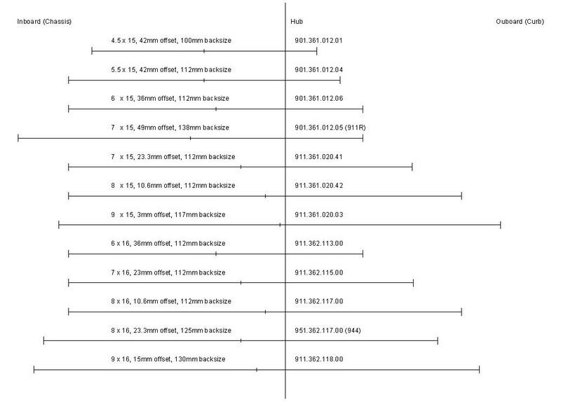

Hi
I am looking at wheels and came across Maxilite, was wondering if anyone had any experience with them. I am getting ready to buy a set of image wheels out of the UK, but want to look at some other options first. They are basically 17 inch Fuchs knock off. Either three-piece or one piece wheel. Thanks Ed |

I looked at those, what are your thoughts on these? I run their wheels on my Mini, very light, three piece https://www.imagewheels.co.uk/billet-110-alloy-wheel/ |

I looked at those, what are your thoughts on these? I run their wheels on my Mini, very light, three piece https://www.imagewheels.co.uk/billet-110-alloy-wheel/ I am having trouble finding 17x9 with a -16 offset, that is why I was thinking custom 3pcs |

I looked at those, what are your thoughts on these? I run their wheels on my Mini, very light, three piece https://www.imagewheels.co.uk/billet-110-alloy-wheel/ I am having trouble finding 17x9 with a -16 offset, that is why I was thinking custom 3pcs Are you sure about the negative offset ? Attached image(s)

I looked at those, what are your thoughts on these? I run their wheels on my Mini, very light, three piece https://www.imagewheels.co.uk/billet-110-alloy-wheel/ I am having trouble finding 17x9 with a -16 offset, that is why I was thinking custom 3pcs Are you sure about the negative offset ? It is a +16 offset, I typed it incorrectly |
