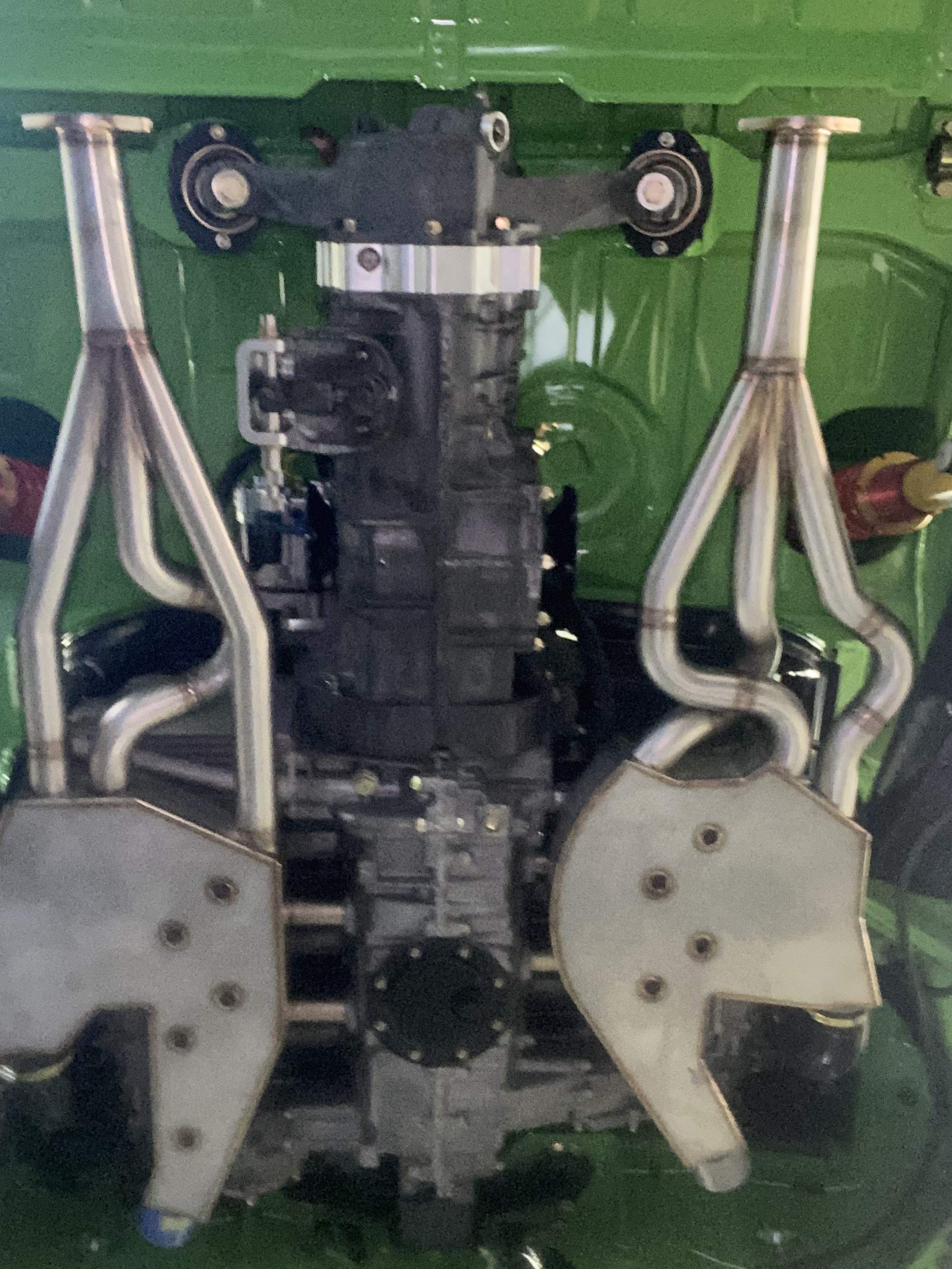

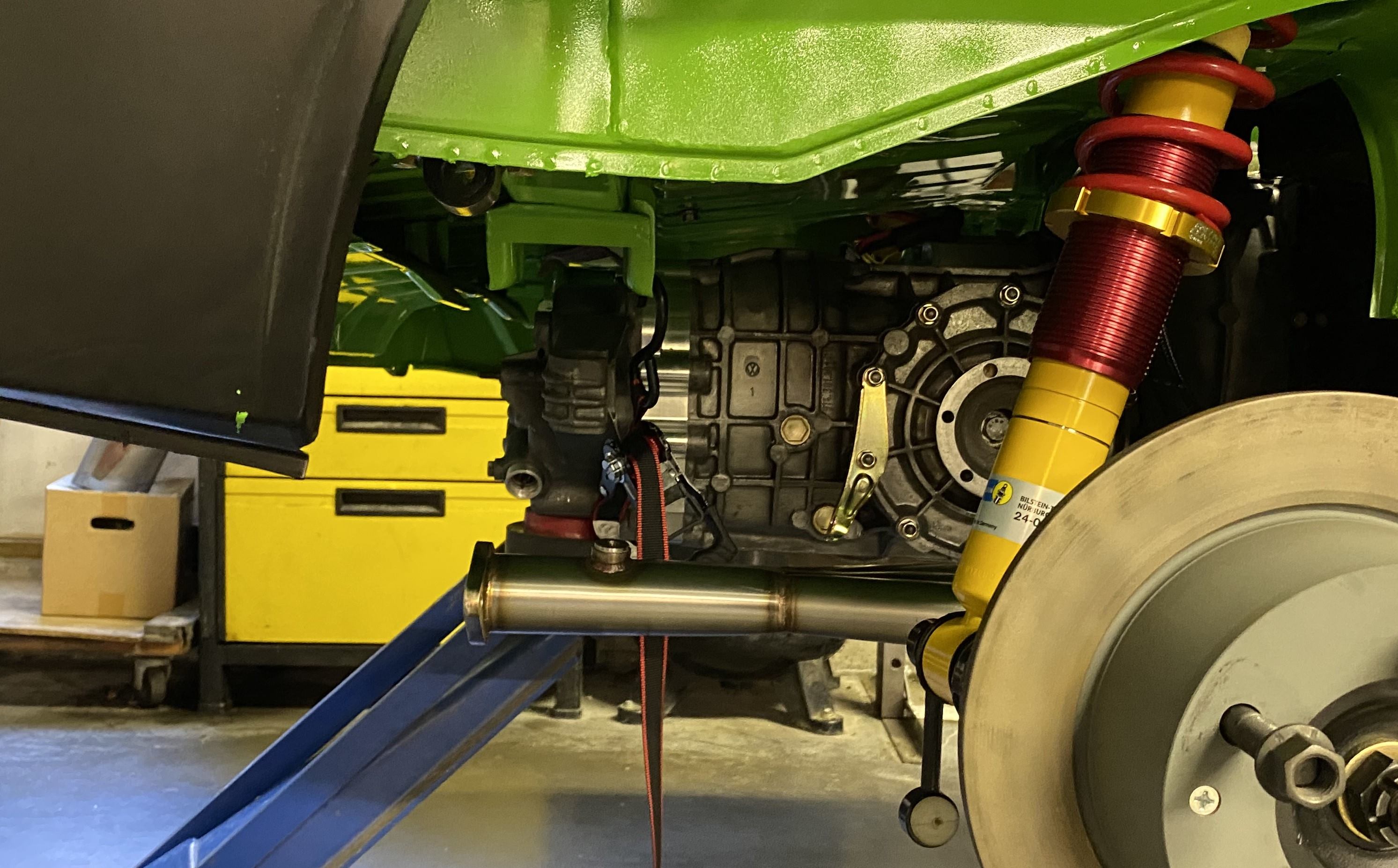

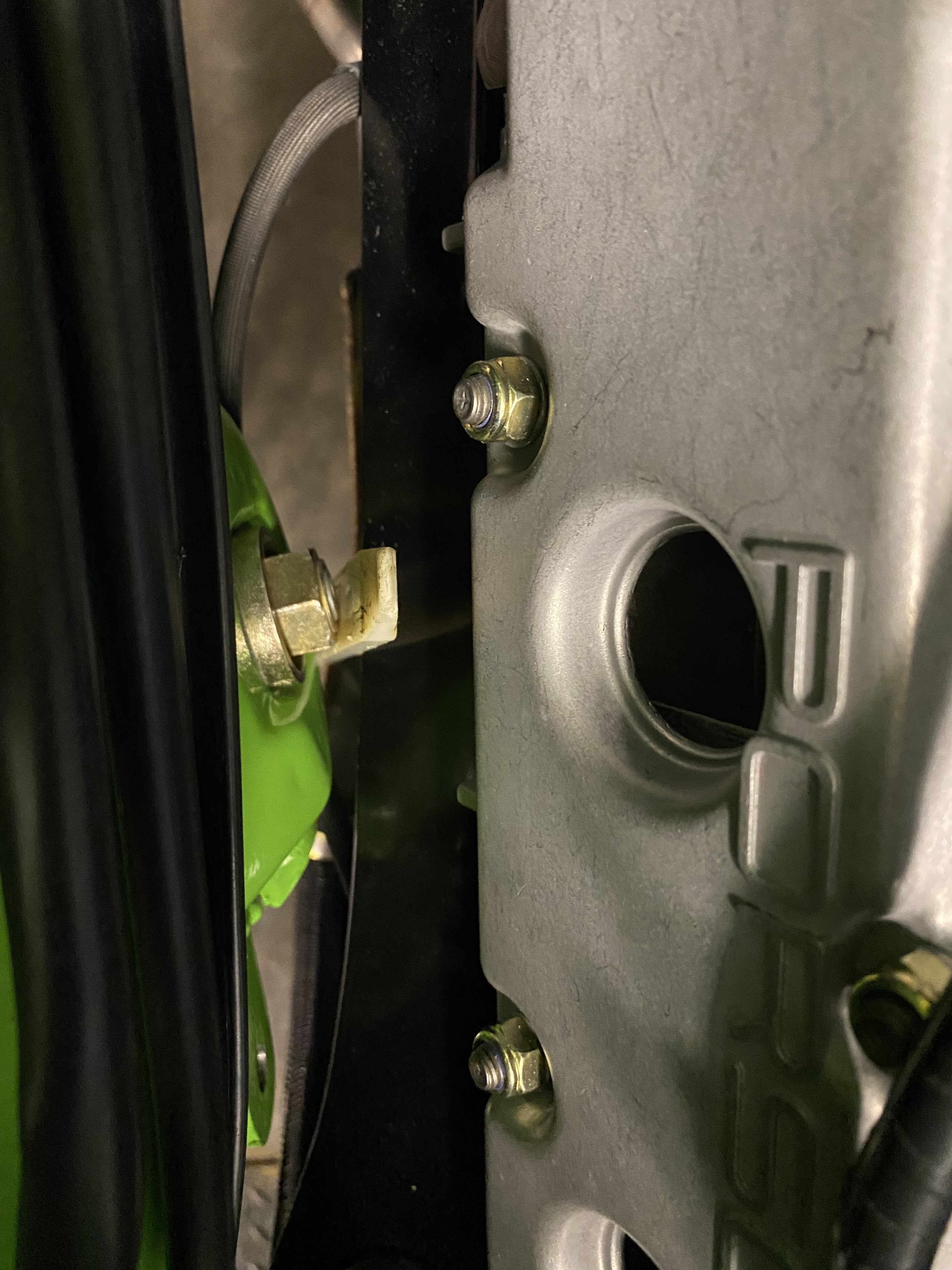

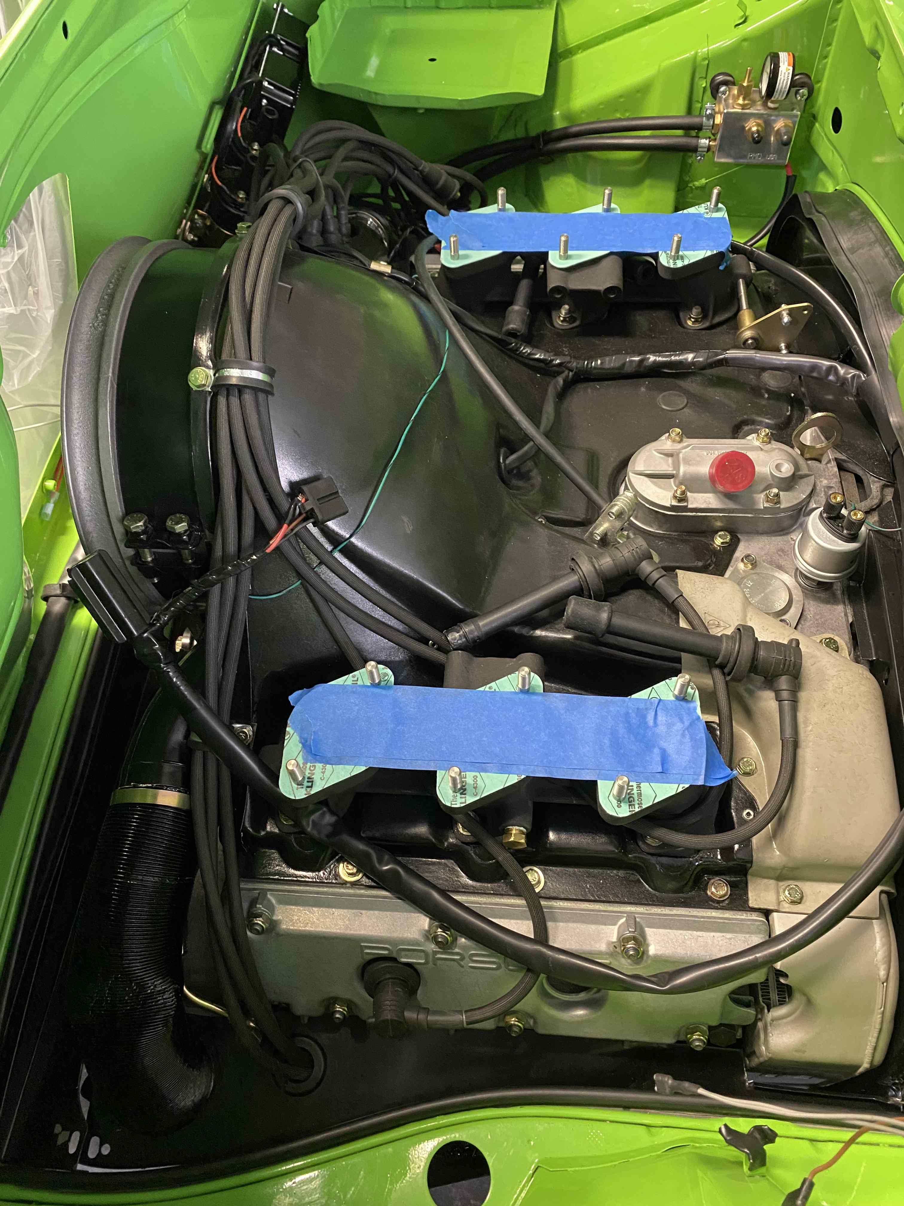

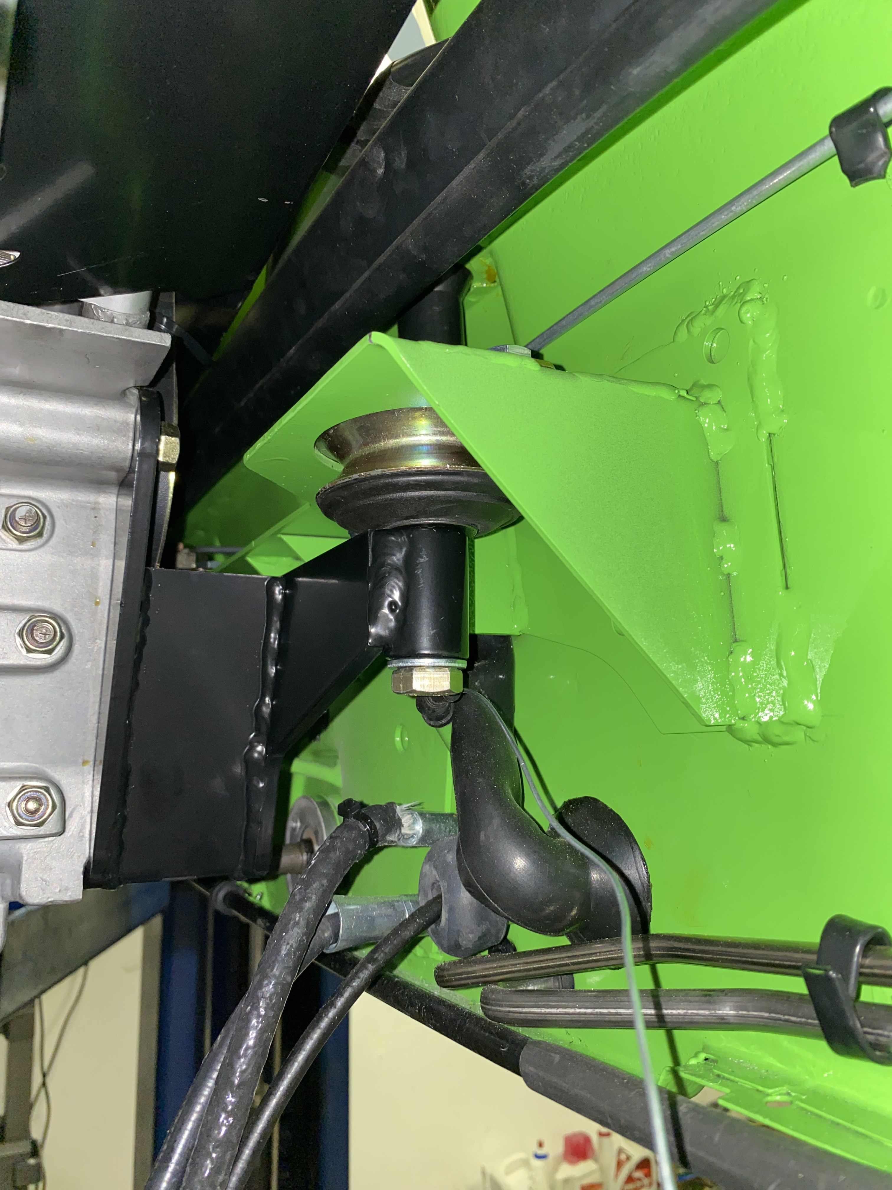

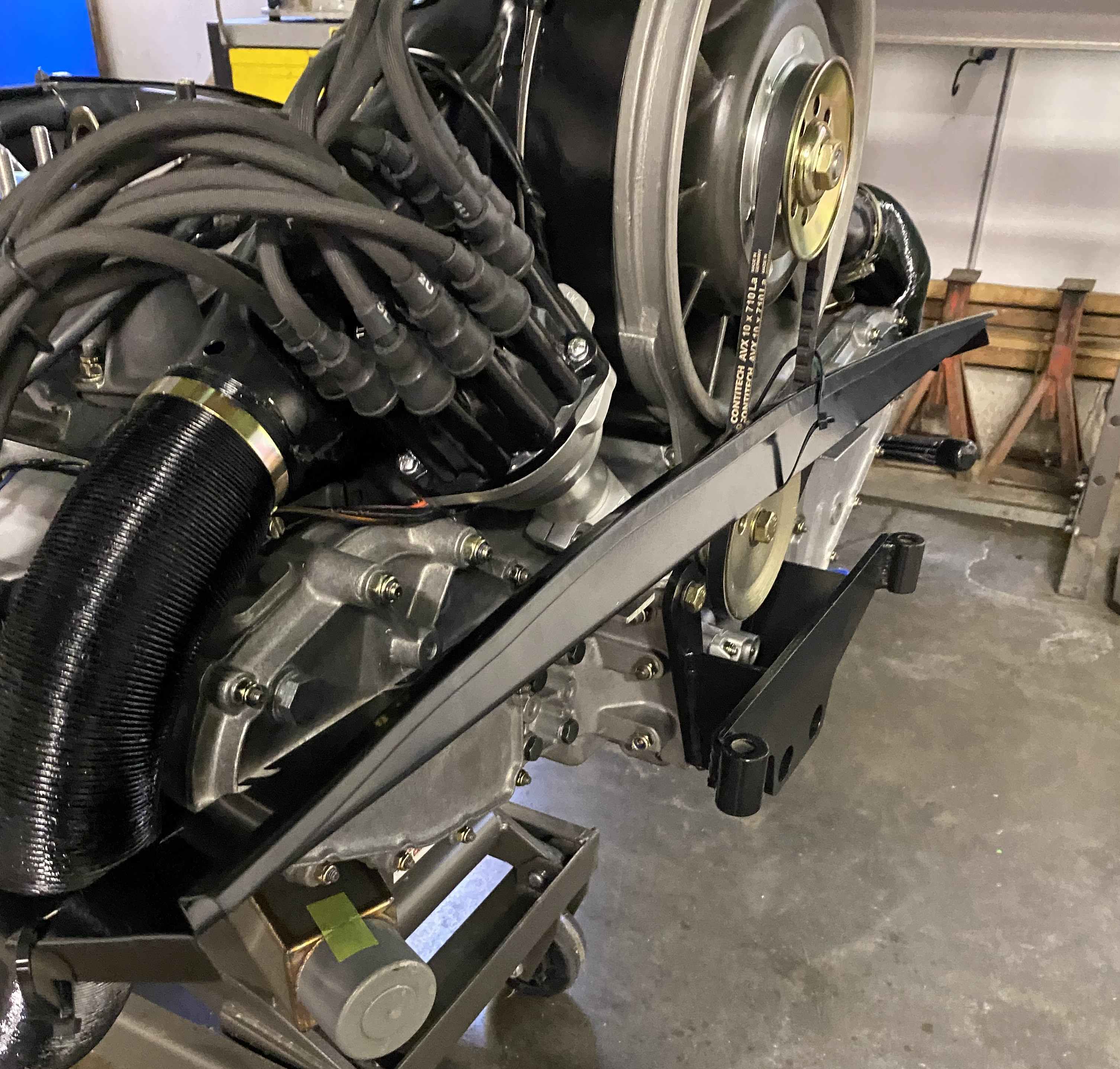

I finished up the engine install today thanks to all the advice I received here.
I think the most important tips I learned here were:
1. Loosing and tipping up the front tin to allow it reach over the top of the Mad Dog mount
2. Reversing the front mount bolts with the nuts on the top and the bolts on the bottom
3. Loosening the side tin and using plastic sliders to allow the tin slide over the trailing arm bolts
4. Using a ratchet strap to temporarily secure the gearbox while removing the lift table and moving the floor jack into place
