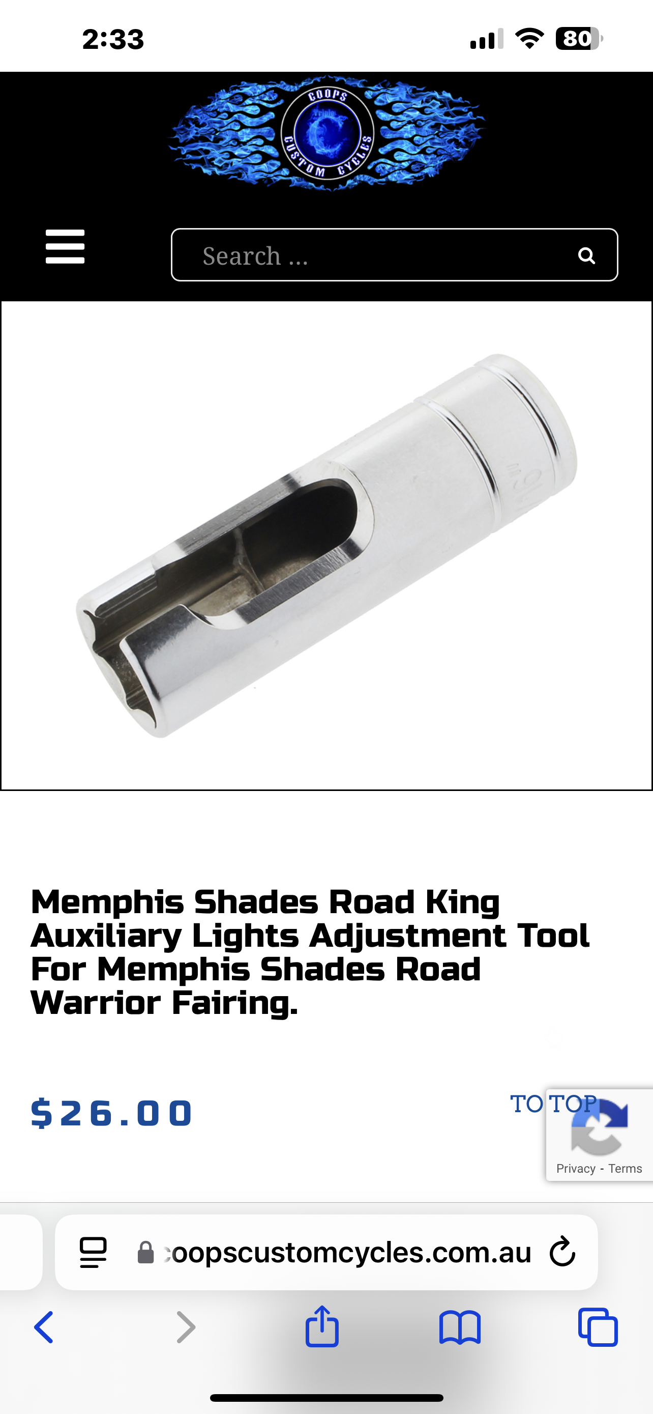

Open end wrench or long nose vise grips? Can't remember.
Or get out the cut off wheel and/or grinder to make one of these out of a deep socket: https://coopscustomcycles.com.au/product/me...arrior-fairing/ |

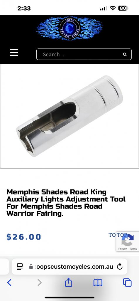

Open end wrench or long nose vise grips? Can't remember. Or get out the cut off wheel and/or grinder to make one of these out of a deep socket: https://coopscustomcycles.com.au/product/me...arrior-fairing/ Pic… Attached thumbnail(s) |
