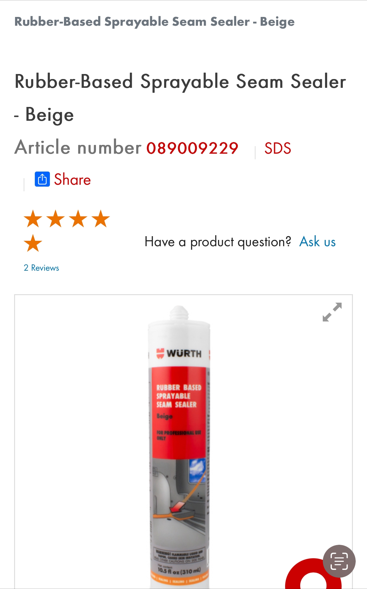

There is a brushable version too. Both sprayed and brushed were factory depending on location. Thanks for that lead. The product description sounds very appropriate for the application. I like there's brushable and gray options. I do see it states "Permanently flexible". If that's the case, if you paint over, won't the paint crack? I wonder if the original was also flexible...just not after 50 years. (IMG:style_emoticons/default/biggrin.gif) |
