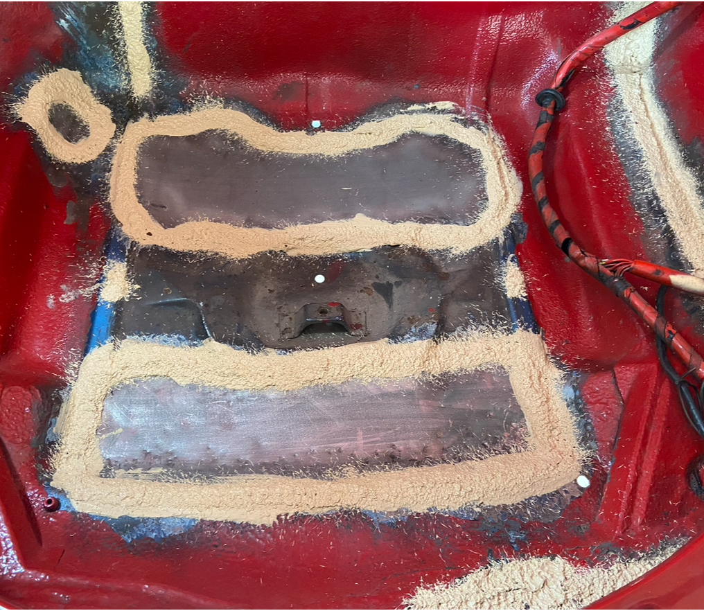

While addressing a couple rust areas, I ran into a hard white substance that was painted over body color. It appears to be squirted or brushed on pretty thick. It wasn't applied with much care. I was able to chip, wire brush, or sand it out. I'm curious:
This is surrounding the heater vent tubes in the engine compartment. ![]() This is covering a half-circle cut-out in the driver floorboard just ahead of the pedals. ![]() I'm guessing the same stuff was used in the rear trunk over the screws holding the muffler shield bracket. |

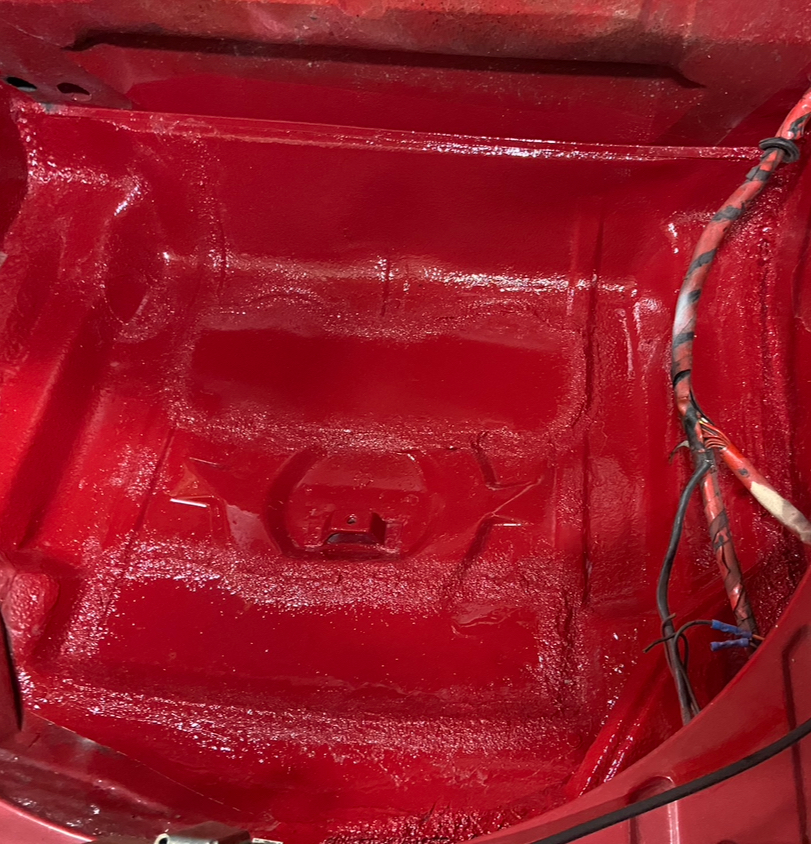

Factory painted over it. Designed to be painted over.
No issues at all. Don’t judge me on the hillbilly AC holes patch job. I have the proper Restoration Design panel but needed these gaping holes filled in short term for a cross country move. Didn’t have time to do it to my satisfaction. (IMG:style_emoticons/default/hissyfit.gif) ![]() ![]() |
