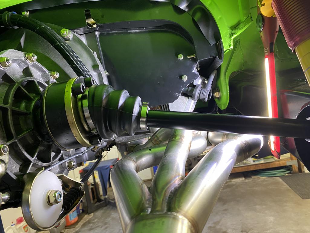

On my -6 GT project I decided to leave the CV/axle installation until after the engine was installed. I figured there has to be a way to change out the CV/axle assembly with the engine in the car.
This afternoon, I went to install them with the stub axle installed on the CV. It was not clear that they would fit. It seemed like I might need to remove the heat exchanger and/or the shock absorber. Any tricks to this? Do I need to install the stub axles before the CV/axle assembly? I can't imagine that I need to remove the engine to install the CV/axles. How is this done? |

Tom1394racing Help - Installing CV/Axle Assemblies after Engine Install? Oct 29 2024, 02:59 PM
Tom1394racing Well, I’ve done a little bit of reading on this ... Oct 29 2024, 07:04 PM
technicalninja Have you had the car aligned yet?
If not, I'd... Oct 29 2024, 07:20 PM
bdstone914 No need to remove the heat exchangers. Remove the ... Oct 29 2024, 07:48 PM
rgalla9146 Bolts out of lower shocks with some way to both lo... Oct 29 2024, 08:50 PM
Tom1394racing Thanks for all your suggestions. I'll try the ... Oct 30 2024, 07:01 AM
Tom1394racing I did the driver's side today. I only needed t... Oct 31 2024, 02:17 PM![]() ![]() |
