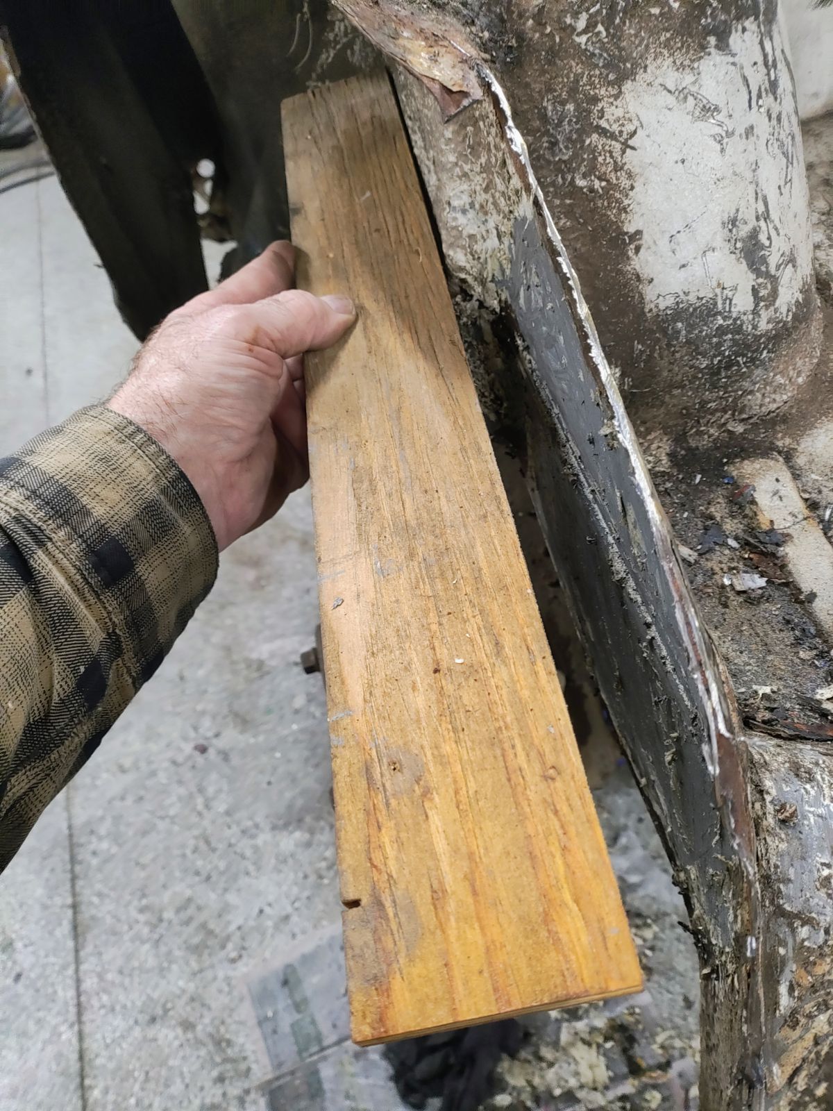

Quarter panel removed to repair poor lap joint
Inside fender panel should be a straight line. I am hoping this has not altered the suspension mounting locations (IMG:style_emoticons/default/idea.gif)
