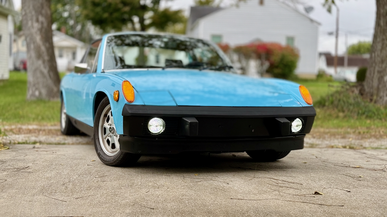

I've posted this before - but these are Pilots with LEDs.

FlacaProductions   I've posted this before - but these are Pilots...   Nov 17 2024, 07:22 PM
dtmehall   Brian Pilots or 914Werke lights? Dan   Nov 17 2024, 07:31 PM
FlacaProductions   Mine are Pilots and Pilots are what 914Werke is se...   Nov 17 2024, 08:57 PM
