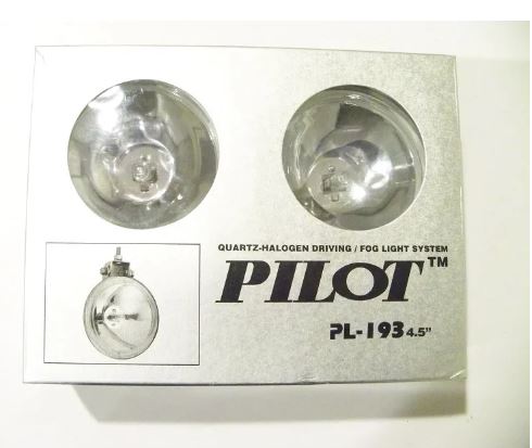

QUOTE(FlacaProductions @ Nov 17 2024, 06:57 PM) *
Mine are Pilots and Pilots are what 914Werke is selling as far as I know.
They are, sans brand packaging.
Pilot automotive no longer directly offer the PL-193 light set.
So I can offer them a bit cheaper including the custom brackets.
Rich

Steve   Pilot lights are the most popular. http://www.auto...   Nov 16 2024, 09:04 PM
drmitch   Pilot lights are the most popular. http://www.aut...   Nov 17 2024, 06:41 PM

FlacaProductions   I've posted this before - but these are Pilots...   Nov 17 2024, 07:22 PM
dtmehall   Brian Pilots or 914Werke lights? Dan   Nov 17 2024, 07:31 PM
FlacaProductions   Mine are Pilots and Pilots are what 914Werke is se...   Nov 17 2024, 08:57 PM
914werke   Mine are Pilots and Pilots are what 914Werke is s...   Nov 18 2024, 11:55 AM
