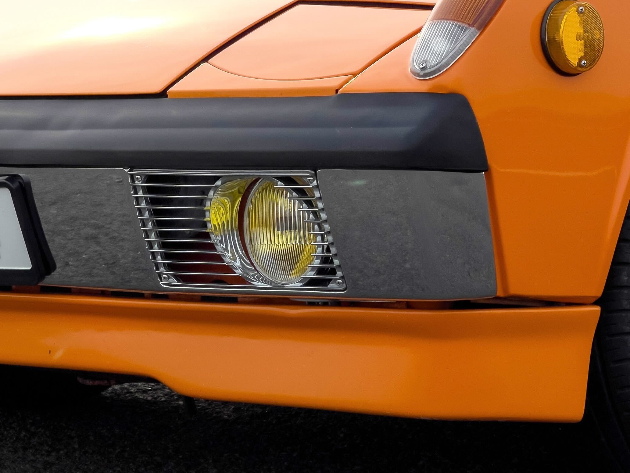

i installed Hella 118 on mine, split fluted lens with yellow reflector and LED bulbs. they fit perfectly in the stock location.
