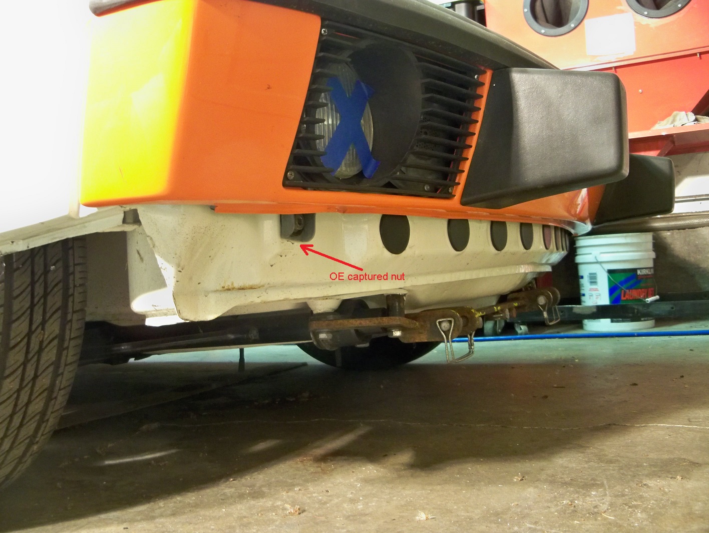

Here is how they are attached to the chassis on all but the earliest of cars up to 74.
75-76 cars obviously have an entirely different setup

QUOTE(914werke @ Nov 19 2024, 01:48 PM) *
THANK YOU!
