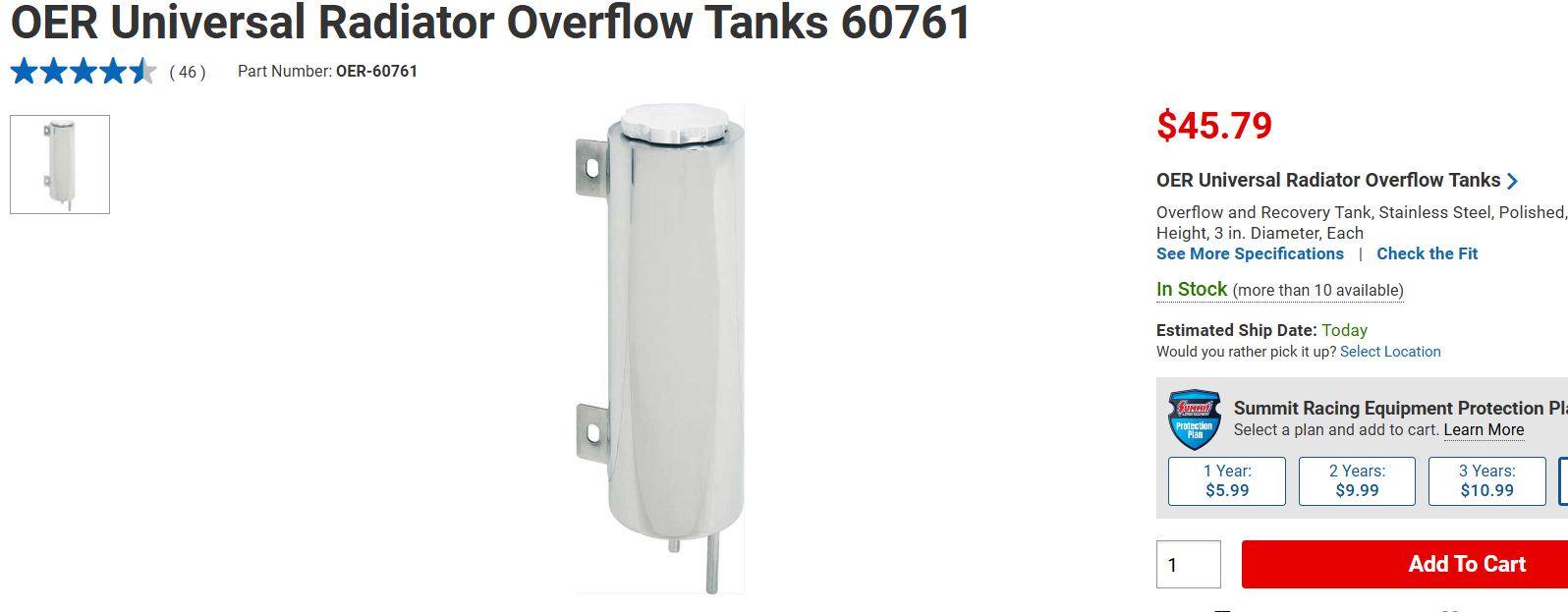

I just ran a small diameter hose to under the car by the steering rack, eliminated the smell inside the car, reduced the smell in the garage quite a bit, it makes the vapor have to work to get out. This would be a good next step.
Might be able to use a radiator overflow tank as an option, I actually own the below for another car, the second tube comes up to the top of the canister, not sure though if that would be too restrictive. The PVC version would be easier to use, just thinking of options. |
