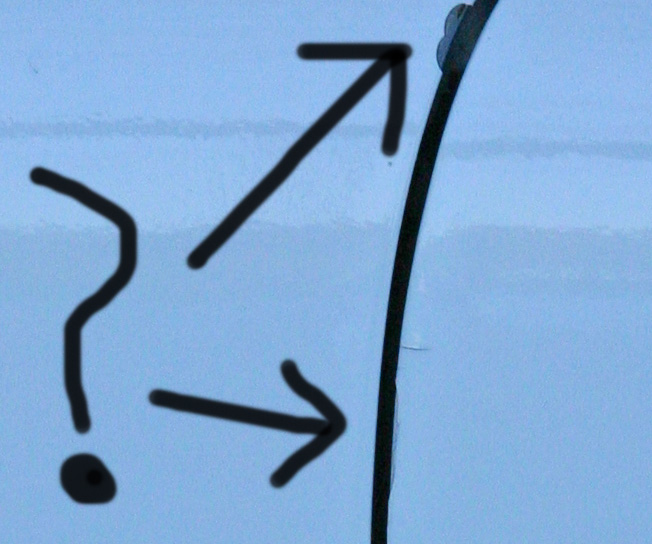

Here is another of the door.
My friend though it could be the door catching if the car was hit at some point. However everything does line up correclty and the door opens/closes well. Yuo can also see in the pics that the reflection across both body panels is almost perfect. Something that can't even be seen on new cars.

Rough_Rider   The creases in the door are because the door limit...   Feb 2 2005, 02:22 PM
