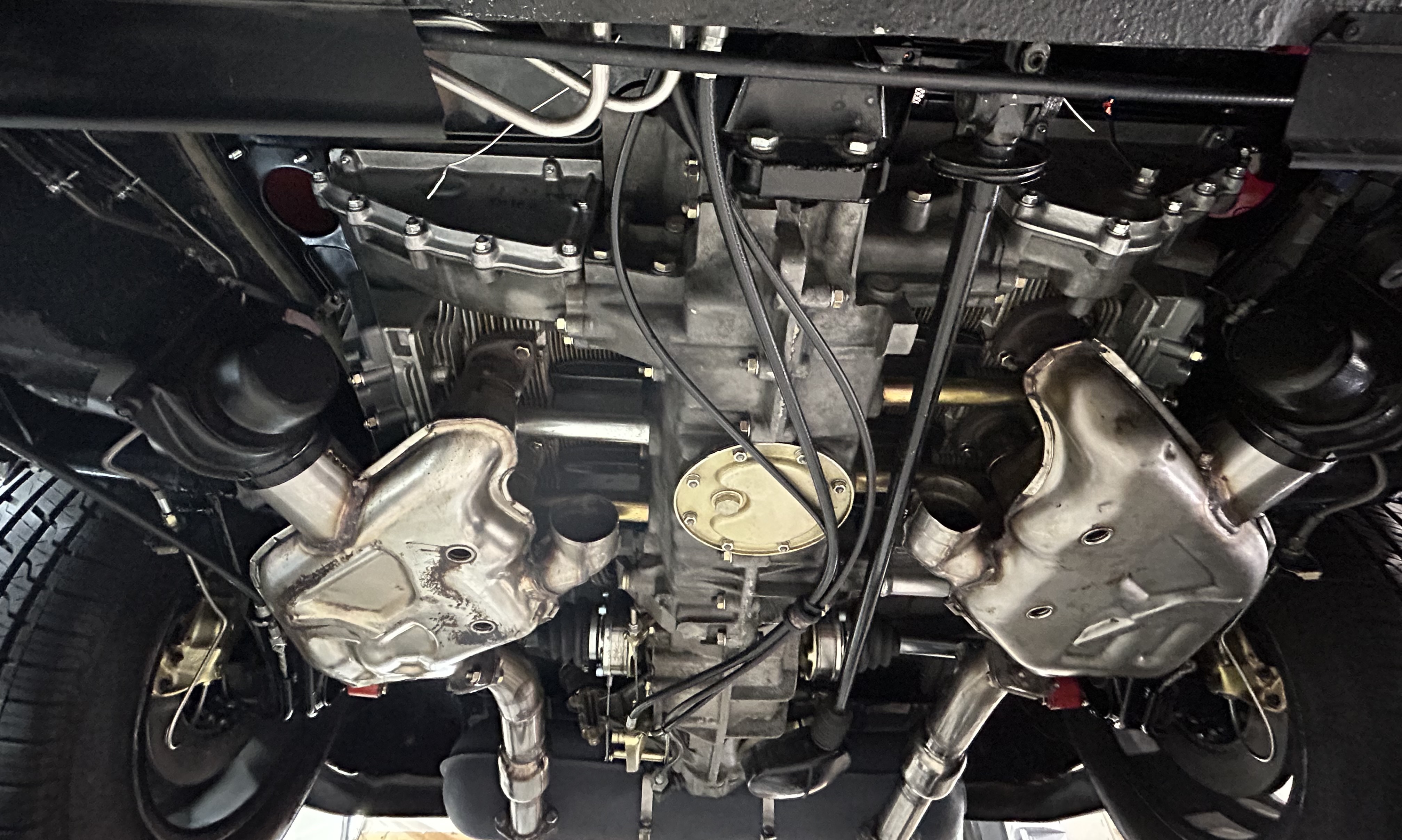

I have been dragging my feet doing these but got a good start this morning. This is a hard process to quote that’s for sure as it is straight up custom. I run this set up on my hot 2.4 with 1.5” sleeves and they work really well. A good solution all the way up to 3.6Attached Image

@MB911 - Ben, can you post an installed picture with them hooked up? Do these flow better than your original, large-tube SS heat exchangers? Will they bolt up to a stock banana muffler? Thanks and Happy Thanksgiving, Michael (IMG:style_emoticons/default/beerchug.gif)

Here is the prototypes on my car. Do they glow more I would no probably not. They are unequal length but 1.625 OD just like my old sets. They connect to a stock muffler that’s the idea. Attached Image
