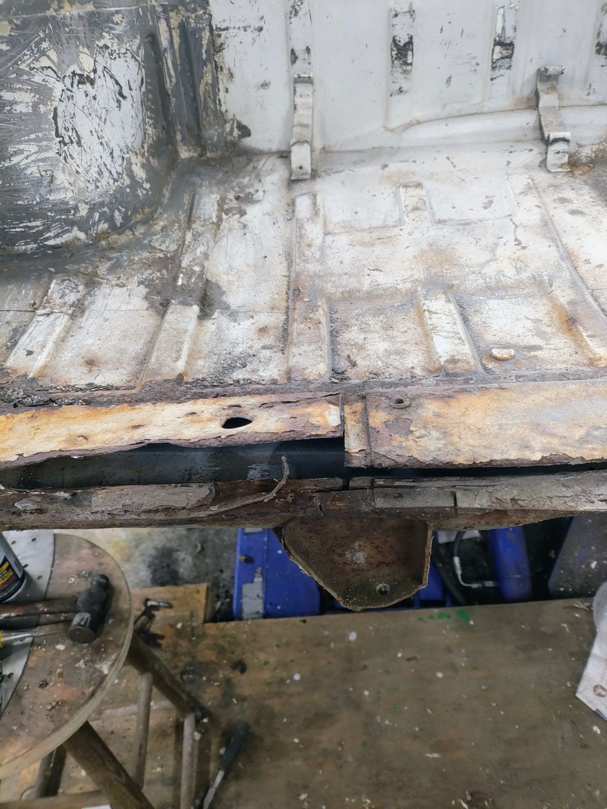

Don't ask, but project #4 is underway. a decent 1974 model without mountains of rust. More pics to follow, but I discovered this yesterday
Attached ImageAttached Image
and this
So goes it. The floors are very good (appear to be), the longs need some small patches including the jack posts,.......
Good winter project

Drivers side portion of trunk floor, crumple did it's job
I am considering a diy (IMG:style_emoticons/default/piratenanner.gif)

Superhawk996   Post pics of the rest of the car. From what you...   Nov 2 2024, 02:28 PM
JamesM   a decent 1974 model without mountains of rust. ...   Nov 2 2024, 11:47 PM
930cabman   we have seen worse   Nov 3 2024, 08:57 AM
Superhawk996   Yeah - sketchy but it isn’t terrible for an east...   Nov 3 2024, 12:05 PM
930cabman   Yeah - sketchy but it isn’t terrible for an eas...   Nov 4 2024, 05:48 PM
Superhawk996   Wondering if I can remove the creased portion, st...   Nov 4 2024, 09:13 PM
930cabman   Wondering if I can remove the creased portion, s...   Nov 5 2024, 06:45 PM
Superhawk996   BTW, update with your new digs? Not really muc...   Nov 9 2024, 08:06 PM
930cabman   BTW, update with your new digs? Not really mu...   Nov 10 2024, 12:23 PM

930cabman   Full width shot Rear firewall appears undamage...   Nov 27 2024, 03:00 PM
Root_Werks   Oh boy, now we're getting into the good stuff...   Nov 27 2024, 04:51 PM
Superhawk996   Still haven’t measured? :poke:   Nov 27 2024, 11:42 PM
930cabman   Still haven’t measured? :poke: Yes, but not ...   Nov 28 2024, 06:47 AM
930cabman   The plan is remove some damaged(easily removable...   Nov 28 2024, 09:48 AM
Superhawk996   :smash: :popcorn:   Nov 28 2024, 12:05 PM

930cabman   Peeling back the onion, currently the plan is t...   Dec 4 2024, 02:06 PM
930cabman   Lots of good metal here, finding the way through i...   Dec 6 2024, 05:53 AM
Superhawk996   I hope you aren’t thinking about doing what I th...   Dec 6 2024, 06:21 AM
930cabman   I hope you aren’t thinking about doing what I t...   Dec 6 2024, 10:28 AM
Superhawk996   I hope you aren’t thinking about doing what I ...   Dec 6 2024, 02:43 PM
930cabman   [quote name='930cabman' post='3180488' date='Dec ...   Dec 6 2024, 03:50 PM
Superhawk996   Ah! That sounds a whole lot more reasonable. ...   Dec 6 2024, 09:47 PM
930cabman   Starting to remove the kinked inner fenderwell ...   Dec 14 2024, 02:18 PM
