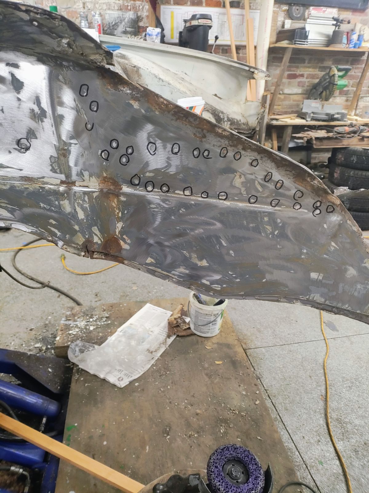

930cabman   Starting to remove the kinked inner fenderwell ...   Dec 14 2024, 02:18 PM
Superhawk996   :popcorn:   Dec 14 2024, 02:42 PM
worn   :popcorn: :agree: :welder: :popcorn:   Dec 14 2024, 08:15 PM
930cabman   Before Kink from the underside   Dec 15 2024, 08:10 AM
930cabman   DP   Dec 15 2024, 10:45 AM
930cabman   Hoping this won't need too much push. Plann...   Dec 15 2024, 01:17 PM
