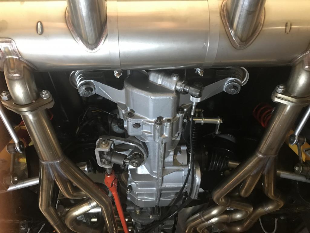

I have Ben's sport muffler and headers. Great sound, little dronning at 3,000 rpm but I don't spend much time there. MarkAttached Image
