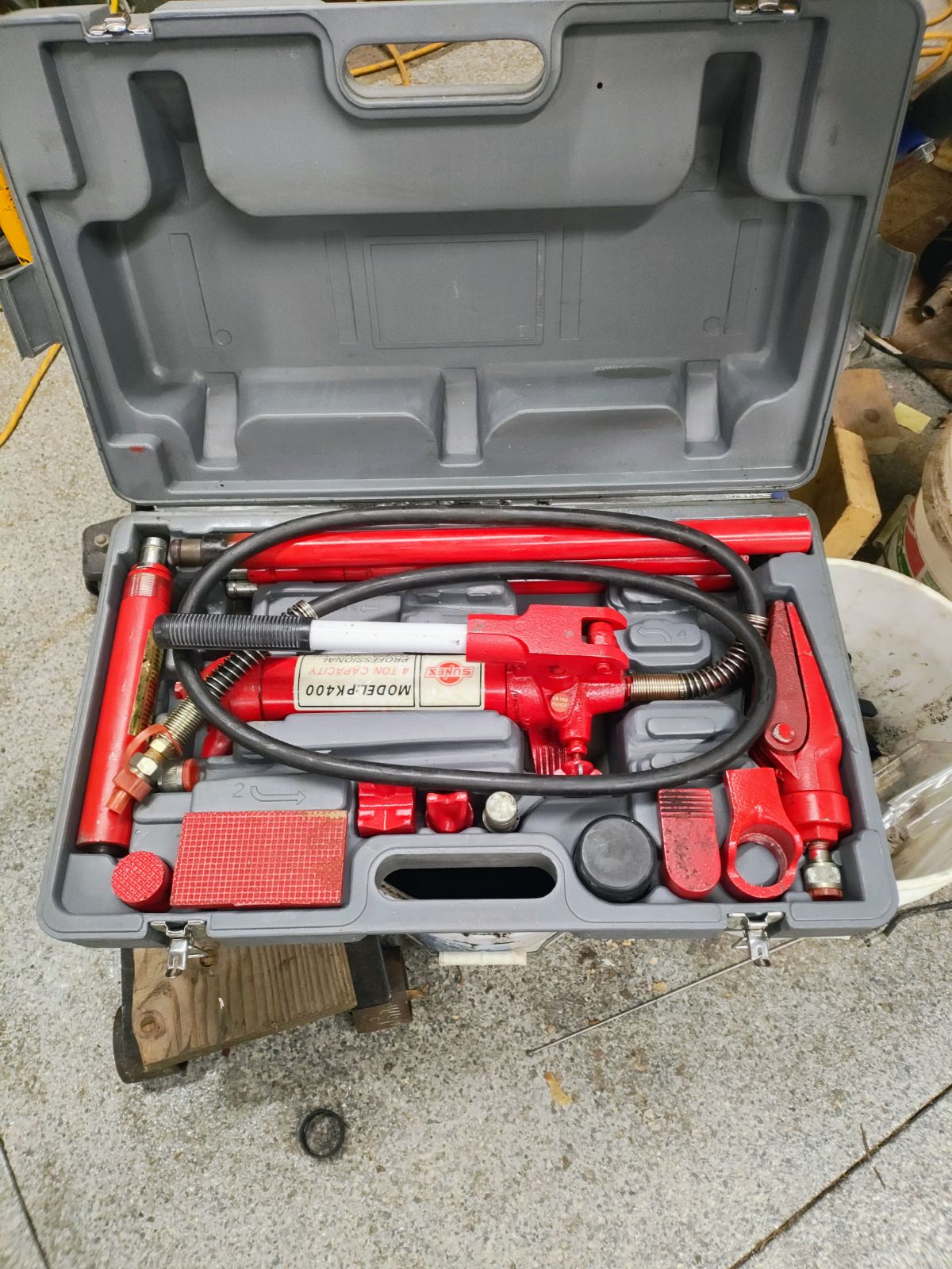

We are planning to move some metal
Cheap, $100.
Looking to secure the chassis to my scissors lift and attaching a pull point from it
A lil push here, a lil pull there
I am lucky the damage is not extensive
Looking to source a bit a salvaged metal to replace kinked/bent stuff
