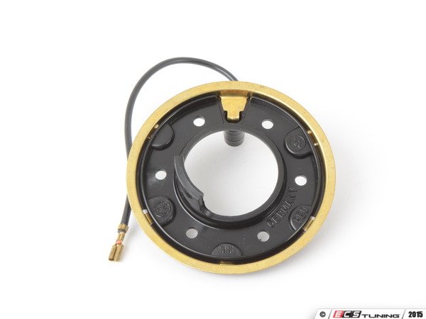

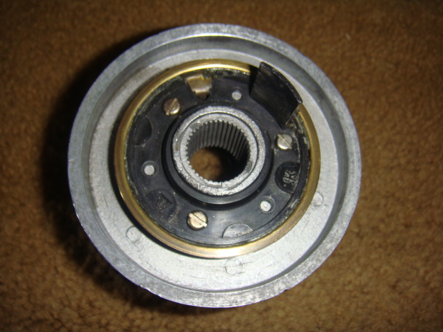

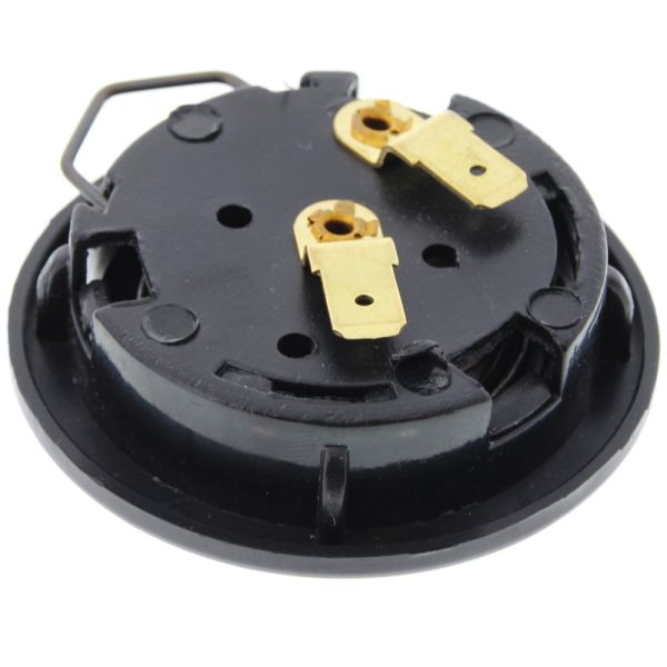

If you can, please post pictures of what you're working with.
The hot should be the original contact ring with a wire going through the wheel hub that's held on by 3 screws. (IMG:http://www.914world.com/bbs2/uploads_offsite/c1552172.ssl.cf0.rackcdn.com-3945-1733236004.1.jpg) Remove that from the stock wheel and it SHOULD be able to be attached to the bottom of the MOMO 8002. I have had clearance issues where the mounting bosses were too tall, so I had to shave some down to avoid the ring from getting jammed against the column face. Should look like this when mounted: (IMG:http://www.914world.com/bbs2/uploads_offsite/forums.pelicanparts.com-3945-1733236005.2.jpg) I've only worked with the horn buttons that have two contacts. One is typically labeled for ground, the other is the hot. If not labeled, the one in the middle is usually the hot. (IMG:http://www.914world.com/bbs2/uploads_offsite/www.akr-performance.com-3945-1733236006.3.jpg) There are two versions of the 8002 hub. One is solid, and one is a cage with a rubber boot around it. The grounding is accomplished differently on each one IIRC. Which one do you have? |
