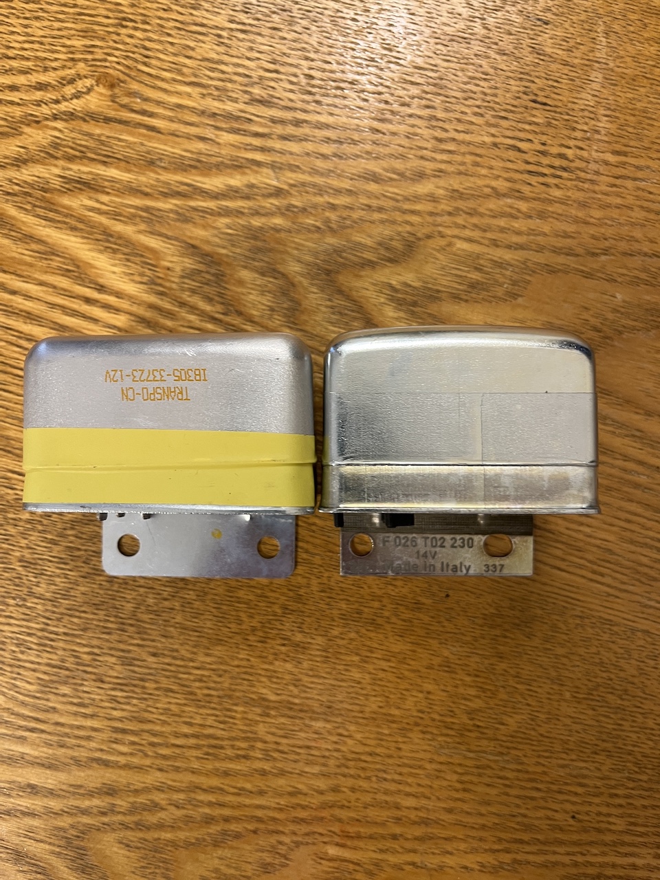

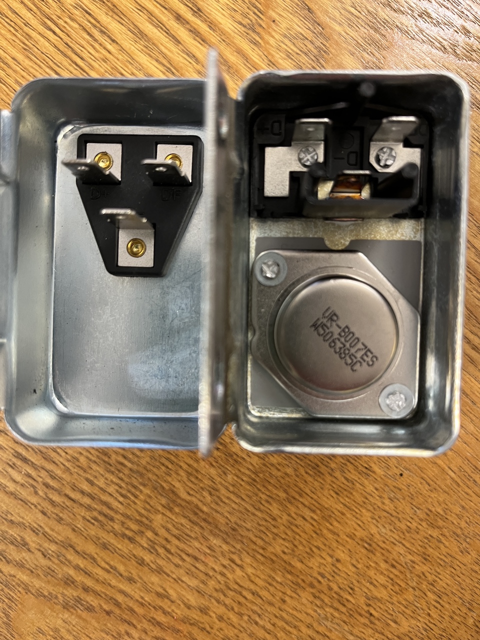

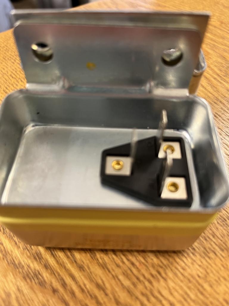

Thought I would show what is going on. The aftermarket are 180 degrees out in the rear and that makes the single one in center out. Depth of bottom is about 1/4" shorter the Bosch one. Aftermarket will work with enlarged holes BUT it still sets higher on the relay board.

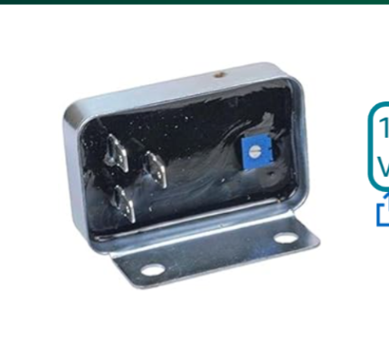

This is the beast I use. Solid state. Has been doing great for a couple years now.
100% NEW HEAVY DUTY VOLTAGE REGULATOR WITH ADJUSTABLE VOLTAGE FEATURE https://a.co/d/eP3pSgl ![]() |
