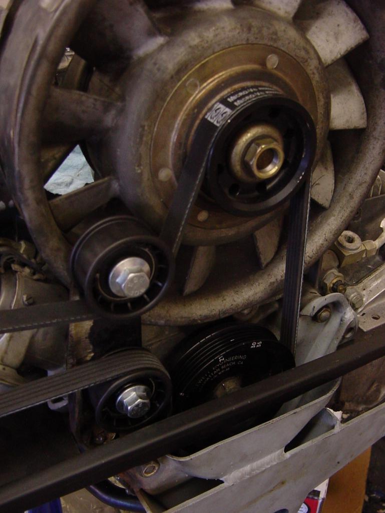

This isn't the exact picture I was looking for, but it will do to explain what I am talking about.

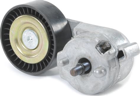

I extended the arm on the motor mount so it went up farther. That way I could put the idlers on to be able to mount the compressor over the valve cover on the right hand side. It worked fine, until the compressor mount cracked the timing cover.
If you extend the arm on the mount, and put a dynamic tensioner on it, similar to the one below, you should be able to run your serpentine belt setup.
I will keep looking for the picture of the belt with the tensioner.
