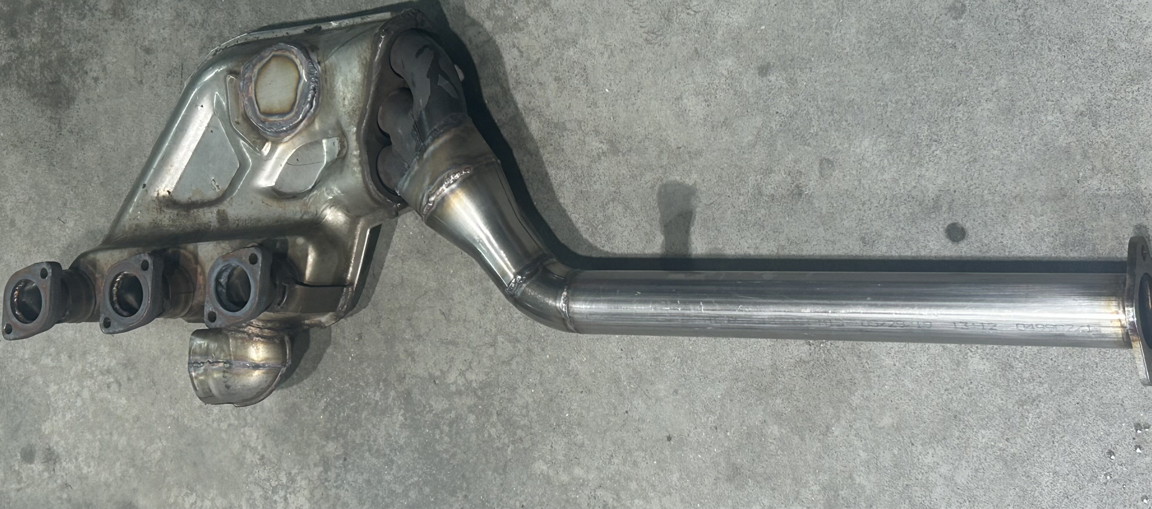

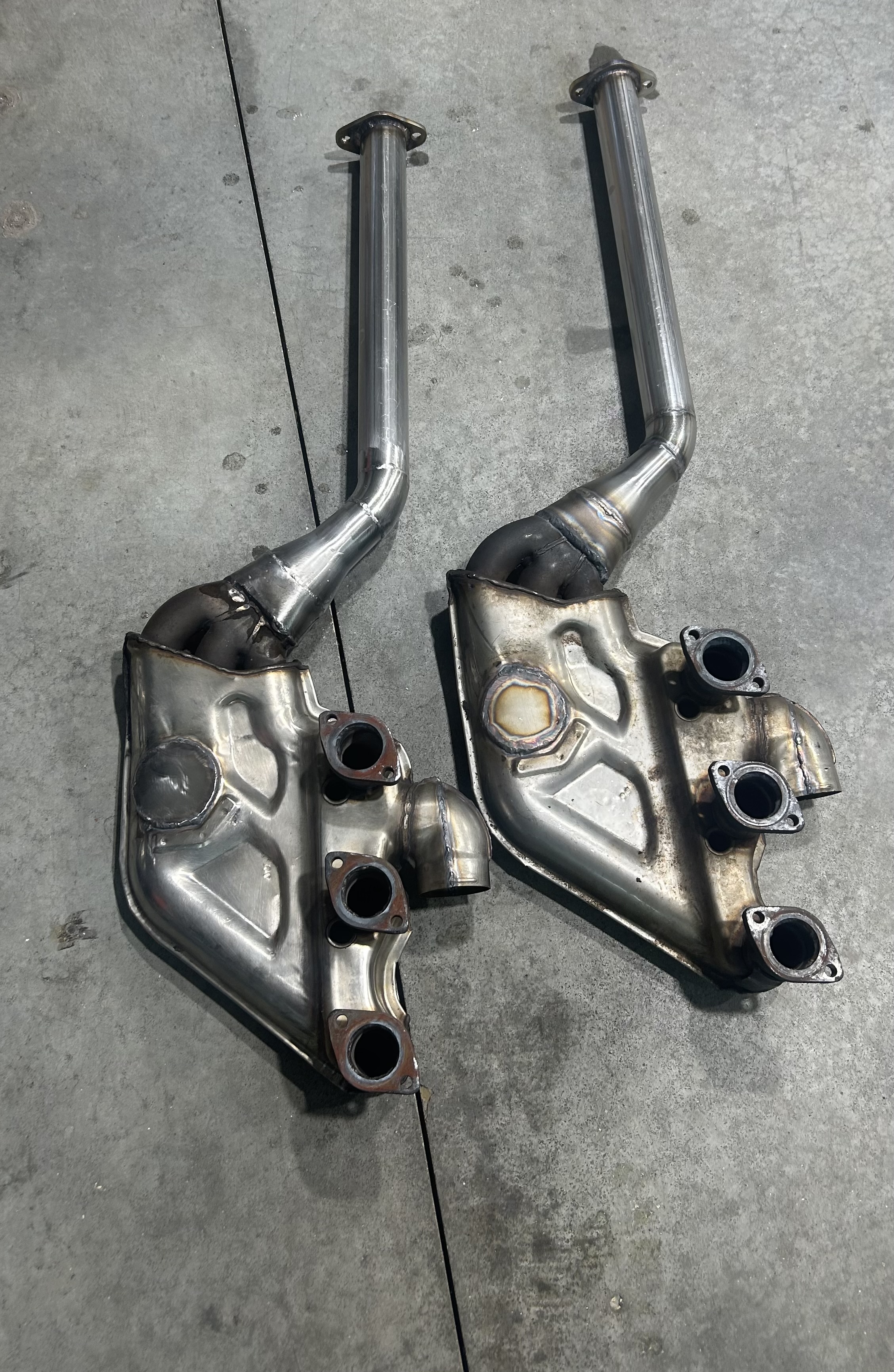

I have been dragging my feet doing these but got a good start this morning. This is a hard process to quote that’s for sure as it is straight up custom. I run this set up on my hot 2.4 with 1.5” sleeves and they work really well. A good solution all the way up to 3.6Attached Image

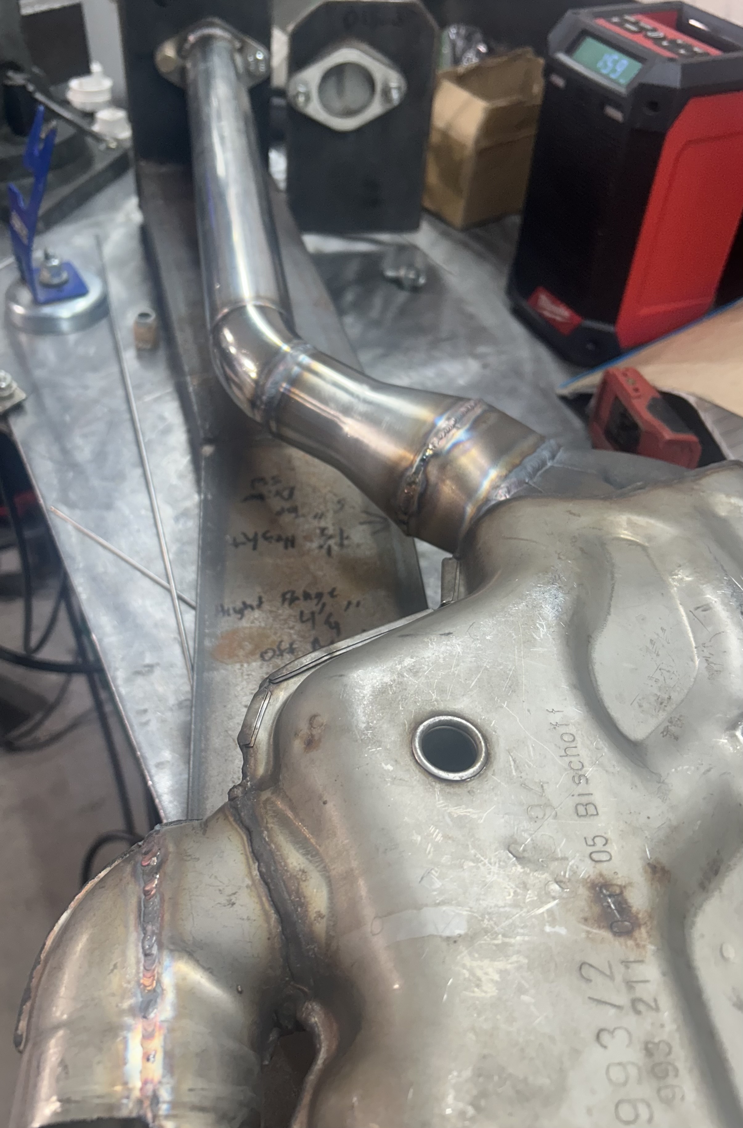

mb911   Starting the adapters.   Nov 28 2024, 08:58 AM

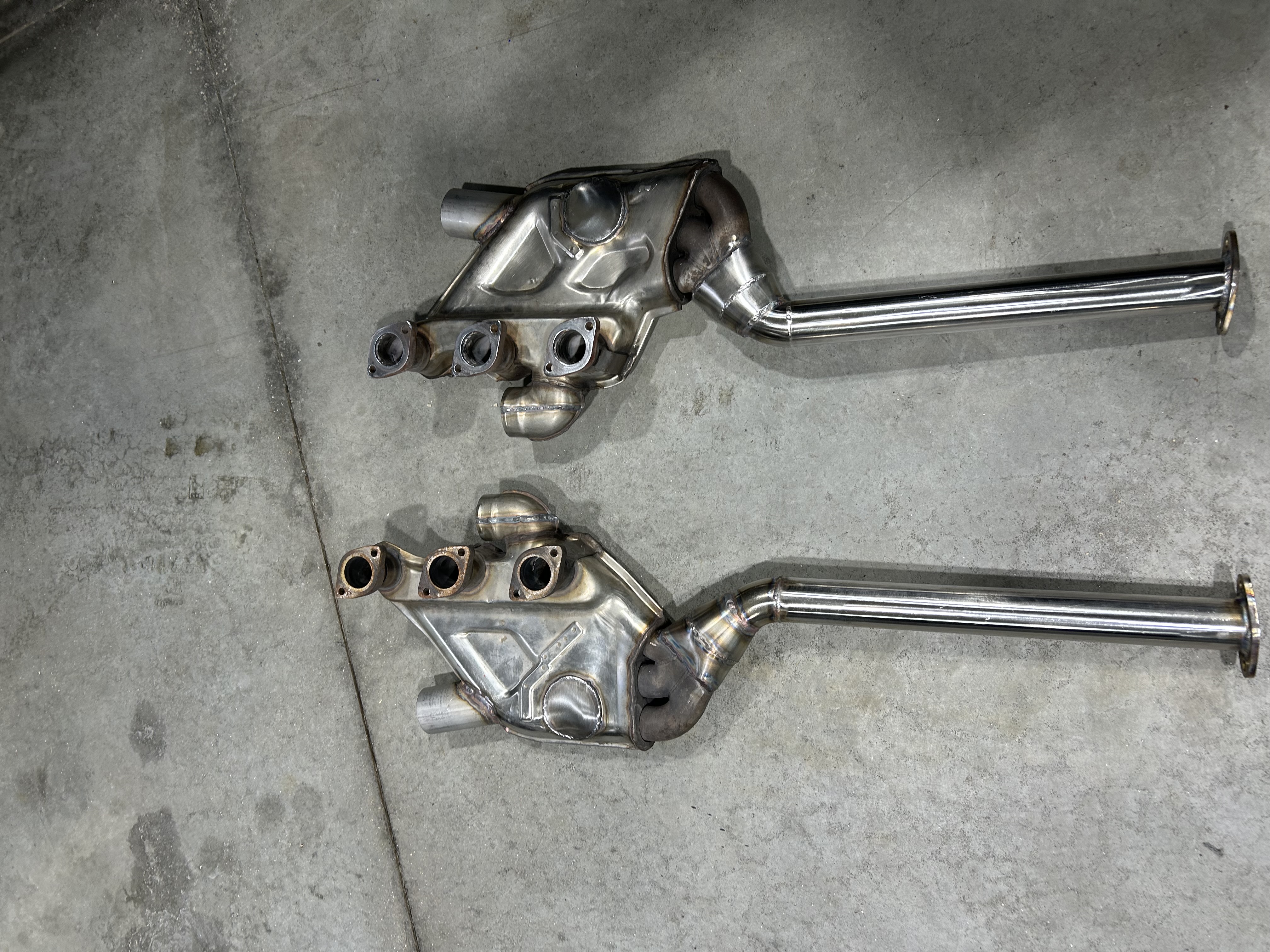

mb911   Second batch   Dec 27 2024, 08:22 AM
