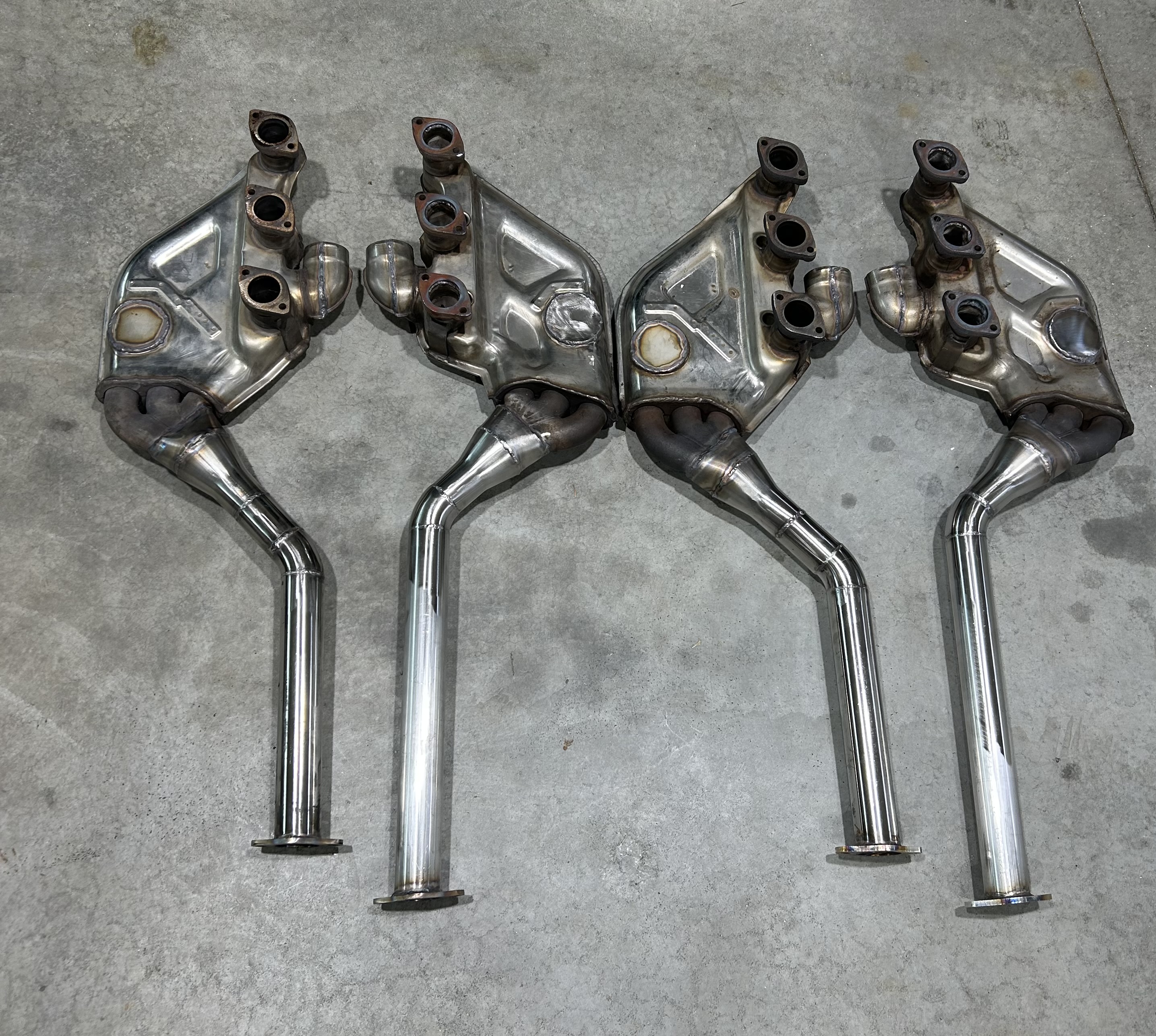

I have been dragging my feet doing these but got a good start this morning. This is a hard process to quote that’s for sure as it is straight up custom. I run this set up on my hot 2.4 with 1.5” sleeves and they work really well. A good solution all the way up to 3.6Attached Image

Agreed^ These might be a good value as I think I have a set of these a friend was going to give me. There seems to be a fair amount of take offs so the cores might be easily available for low cost.

ClayPerrine   Ben, How do you deal with having to flip the flang...   Nov 29 2024, 06:30 AM
mb911   Ben, How do you deal with having to flip the flan...   Nov 29 2024, 07:43 AM
mb911   Ben, How do you deal with having to flip the flan...   Nov 29 2024, 02:21 PM

jc73-914   Hi Ben, did you use the OEM type head to HE gasket...   Nov 30 2024, 06:00 PM
mb911   Hi Ben, did you use the OEM type head to HE gaske...   Nov 30 2024, 07:18 PM

mb911   Bischoff are easier to convert. I am in process of...   Dec 21 2024, 03:30 PM

NARP74   What hanger and muffler clamp are used for these?   Dec 22 2024, 11:09 AM
mb911   What hanger and muffler clamp are used for these?...   Dec 22 2024, 12:14 PM
NARP74   Stock 1.7, 1.8, 2.0?   Dec 22 2024, 12:25 PM
mb911   Stock 1.7, 1.8, 2.0? Sorry 914-6 and 2.0 are t...   Dec 22 2024, 12:57 PM
