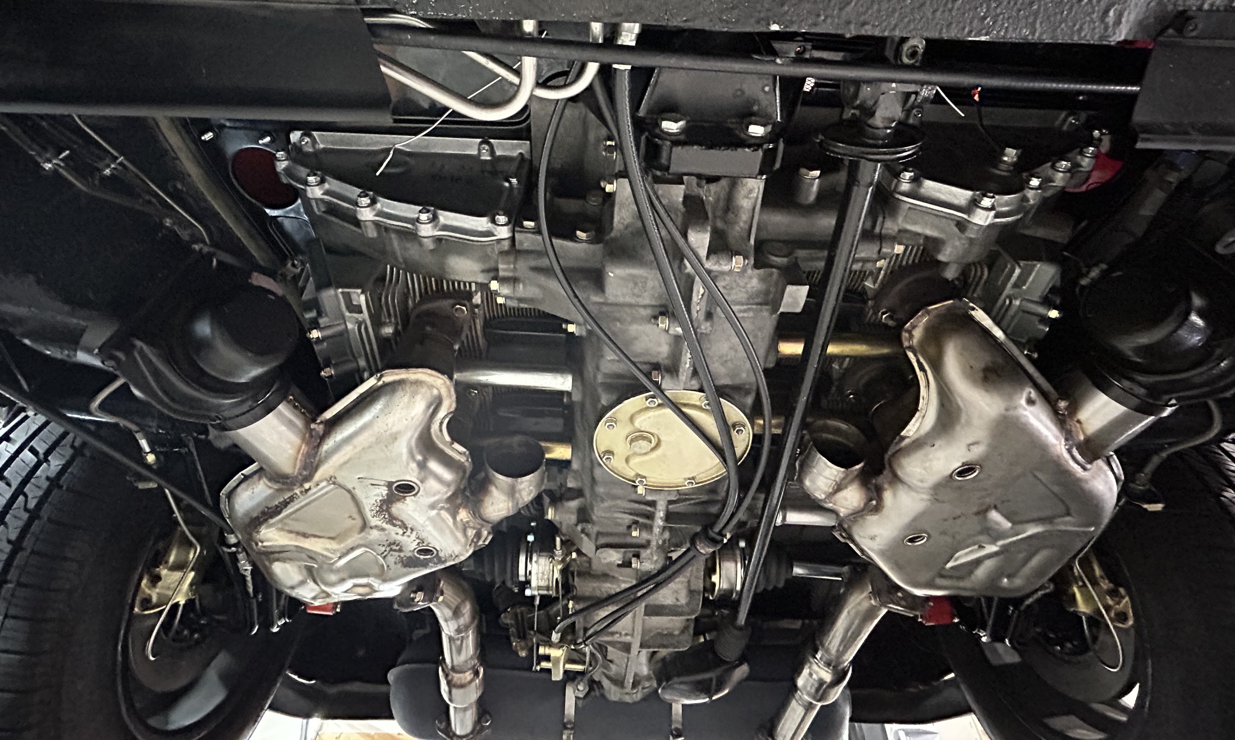

I have been dragging my feet doing these but got a good start this morning. This is a hard process to quote that’s for sure as it is straight up custom. I run this set up on my hot 2.4 with 1.5” sleeves and they work really well. A good solution all the way up to 3.6Attached Image

Where is the other heat port after you are done? Did you show it in the older pics?

Here are the prototypes on my car.Attached Image
