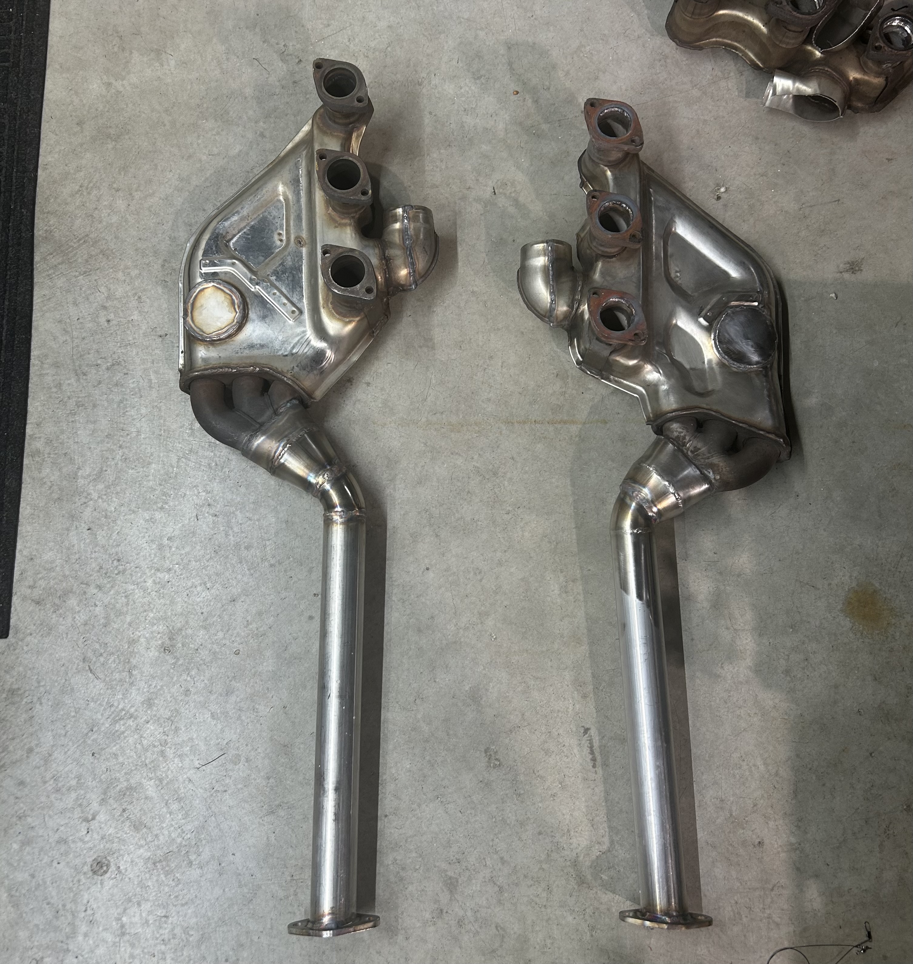

I have been dragging my feet doing these but got a good start this morning. This is a hard process to quote that’s for sure as it is straight up custom. I run this set up on my hot 2.4 with 1.5” sleeves and they work really well. A good solution all the way up to 3.6Attached Image

Minor modifications for clearance Attached Image

mepstein   “This is a hard process to quote that’s for su...   Nov 27 2024, 09:34 AM
mb911   “This is a hard process to quote that’s for s...   Nov 27 2024, 10:03 AM

Cairo94507   @MB911 - Ben, can you post an installed picture w...   Nov 27 2024, 09:44 AM
mb911   [b]@[url=http://www.914world.com/bbs2/index.php?s...   Nov 27 2024, 10:02 AM

NARP74   @MB911 do the open ports in your pic get a hose f...   Nov 27 2024, 06:04 PM
mb911   [b]@[url=http://www.914world.com/bbs2/index.php?s...   Nov 27 2024, 09:16 PM

ClayPerrine   Ben, How do you deal with having to flip the flang...   Nov 29 2024, 06:30 AM
mb911   Ben, How do you deal with having to flip the flan...   Nov 29 2024, 07:43 AM
mb911   Ben, How do you deal with having to flip the flan...   Nov 29 2024, 02:21 PM
ClayPerrine   [quote name='ClayPerrine' post='3179385' date='No...   Nov 29 2024, 04:01 PM
mb911   [quote name='ClayPerrine' post='3179385' date='N...   Nov 29 2024, 06:54 PM

horizontally-opposed   I run these on my 2.4 with 1.5 inch sleeves in th...   Nov 29 2024, 05:12 PM

jc73-914   Hi Ben, did you use the OEM type head to HE gasket...   Nov 30 2024, 06:00 PM
mb911   Hi Ben, did you use the OEM type head to HE gaske...   Nov 30 2024, 07:18 PM
