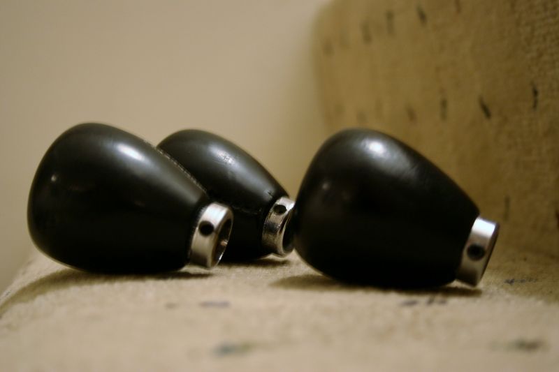

If you want something with a set screw, find an AMCO knob that looks like this.
I have one on mine - rock solid. Came with my 73 when I was a kid - found one on ebay when I got my 74.

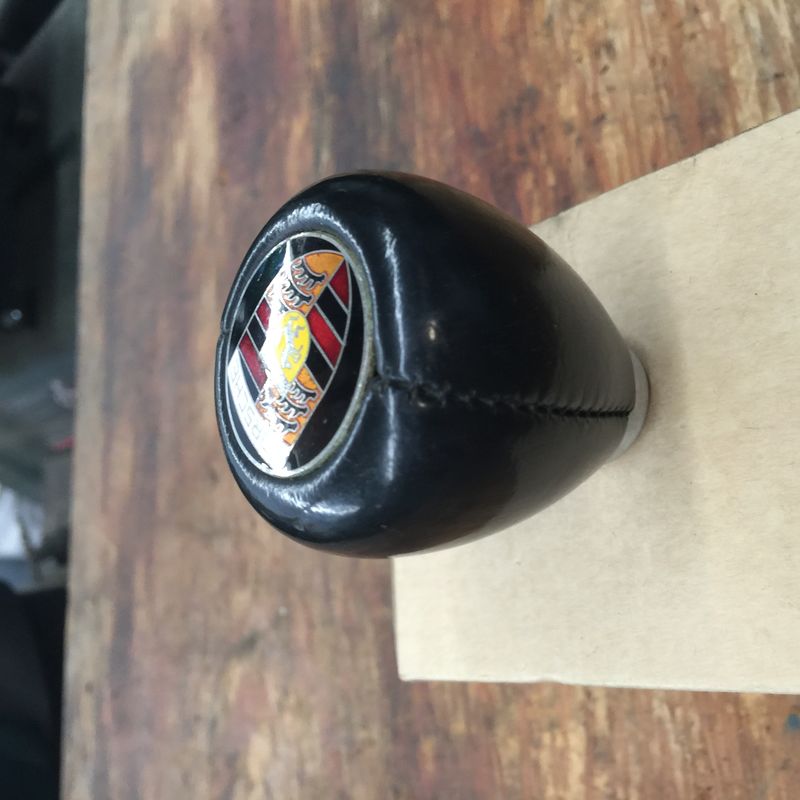

RAX914   Is it a factory shift knob like the picture below?...   Nov 23 2024, 11:57 AM
