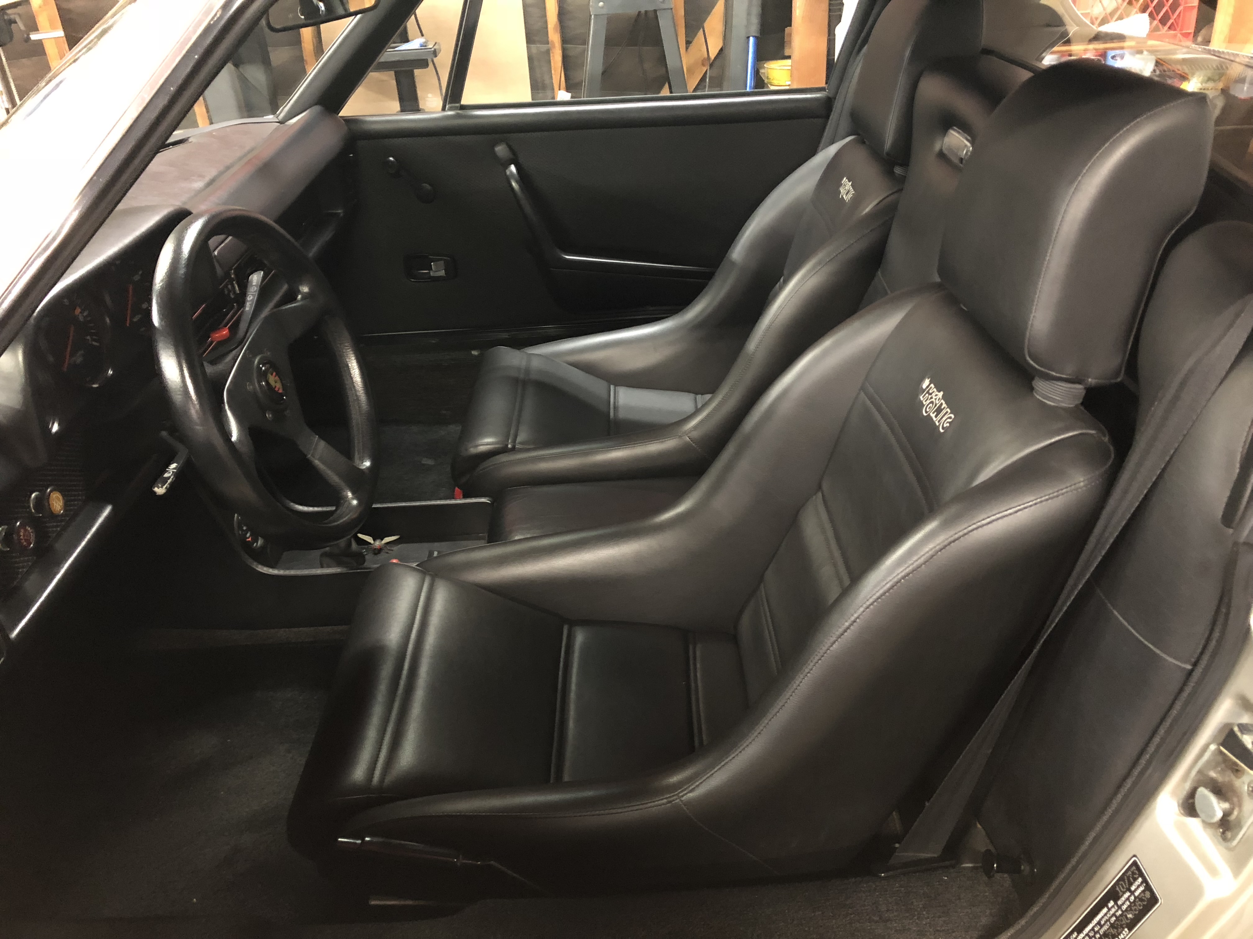

Recaro Pole Positions, there's a seat bracket that adapts it to the stock sliders.
Attached ImageAttached Image
If you want them to look vintage then find a set of Scheels or Konigs, also use stock sliders.
Those are the plug and play options, but both not cost conscious. You can of course just do the drivers side, also an option, just not sure on the plug and play aspect, lots to choose from on https://www.classiccarseats.com/ (IMG:style_emoticons/default/beer3.gif)
