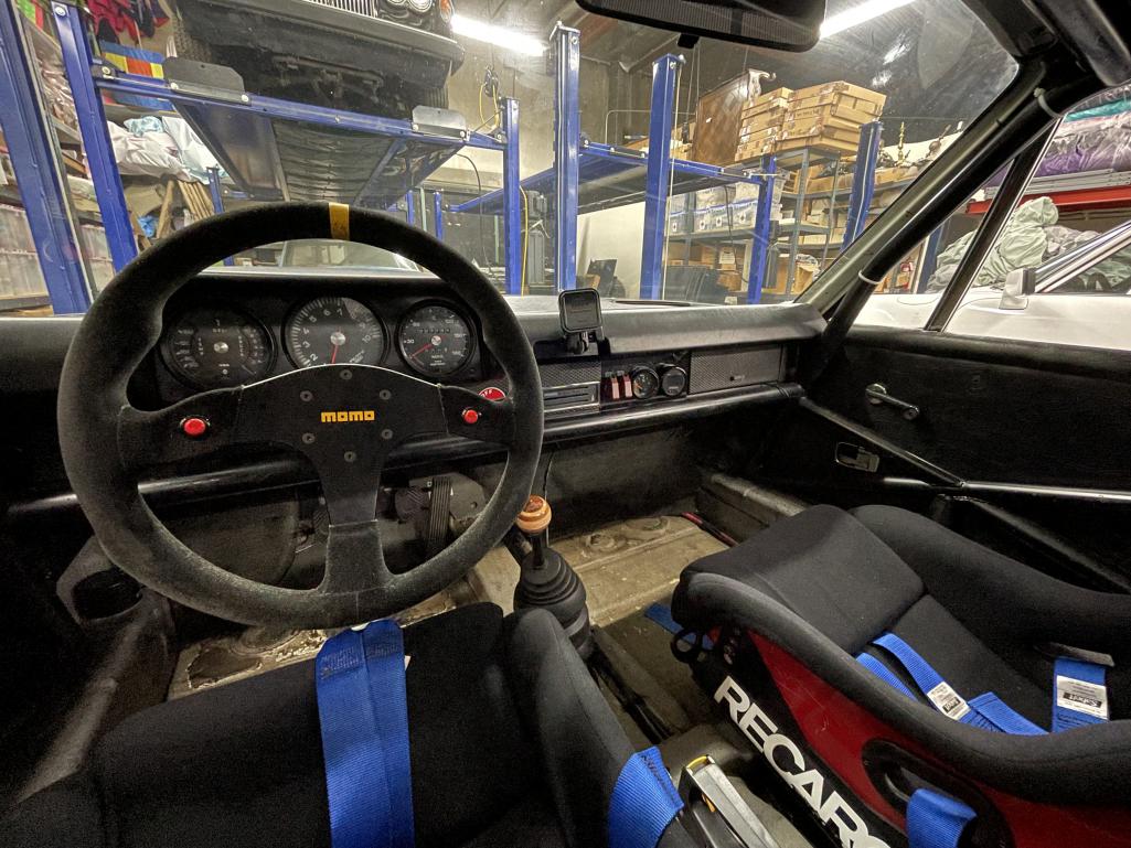

So kind of at a crossroads right now with the 6. Have just had the pans restored to original configuration and do not want to add holes back to the floor. Want to use the normal seat base arrangement for driver and fixed seat for passenger as per original in 1970. I don't take passengers on the track but may title and street the car on occasion. I don't mind having two sets of seats per se (one street one track) but definitely do not want to add back side mount and drill holes in the floor again.
Any advice from this fine collection of 914 gurus?

Yes, check your headroom, the recaros end up sitting higher than stock seats, but if you can lay them back a little you can get more headroom. I’ve got SPGs in my car, they are super comfortable. They are mounted to the sliders.

eric9144   Recaro Pole Positions, there's a seat bracket ...   Dec 17 2024, 12:03 PM

eric9144   Pole positions may be a good option provided they...   Dec 17 2024, 03:21 PM

rgalla9146   IIRC the passenger side hinges can be bolted to th...   Dec 17 2024, 04:21 PM

BillJ   6' 190 lbs 33" waist. Seats i have now sa...   Dec 17 2024, 10:59 PM
infraredcalvin   6' 190 lbs 33" waist. Seats i have now s...   Dec 18 2024, 08:23 AM
