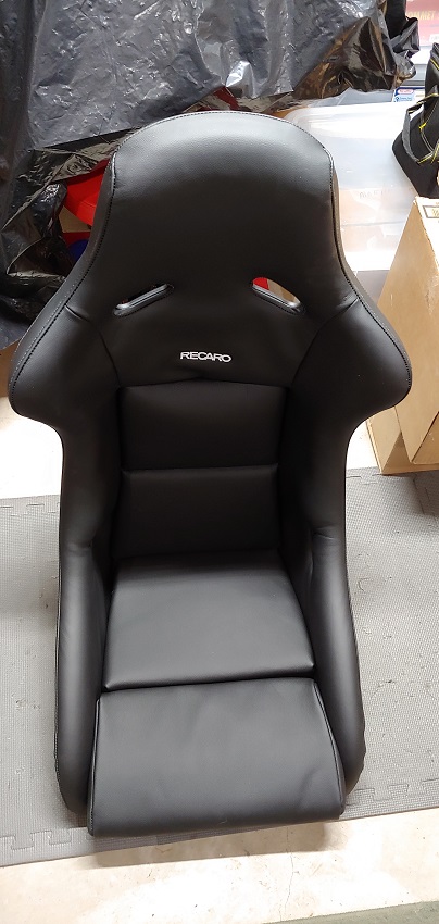

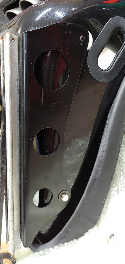

QUOTE(BillJ @ Dec 17 2024, 10:13 AM) *
Pole positions may be a good option provided they come with an fia cert.
Pretty sure they are stickered on the backs with the cert. I've seen the brackets a couple places, I know Patrick Motorsports sells them but I saw them elsewhere recently too, they're pretty simple, but easy.
https://patrickmotorsports.com/products/int...=15351791911027
Edit--you can see the FIA sticker on the drivers seat in the first pic

QUOTE(eric9144 @ Dec 17 2024, 02:21 PM) *
I have a set of Recaro seats just like Eric's for my 6. I purchased the PMS brackets but they didn't bolt up to my seats/factory rails. Recaro changed the mount bracket position on newer seats which is what I ran into. PMS is also currently out of stock on his brackets. I ordered a set several months ago to see if I could have a pair made up locally but with the correct mount position. Maybe call PMS and see if they are working on this update?
