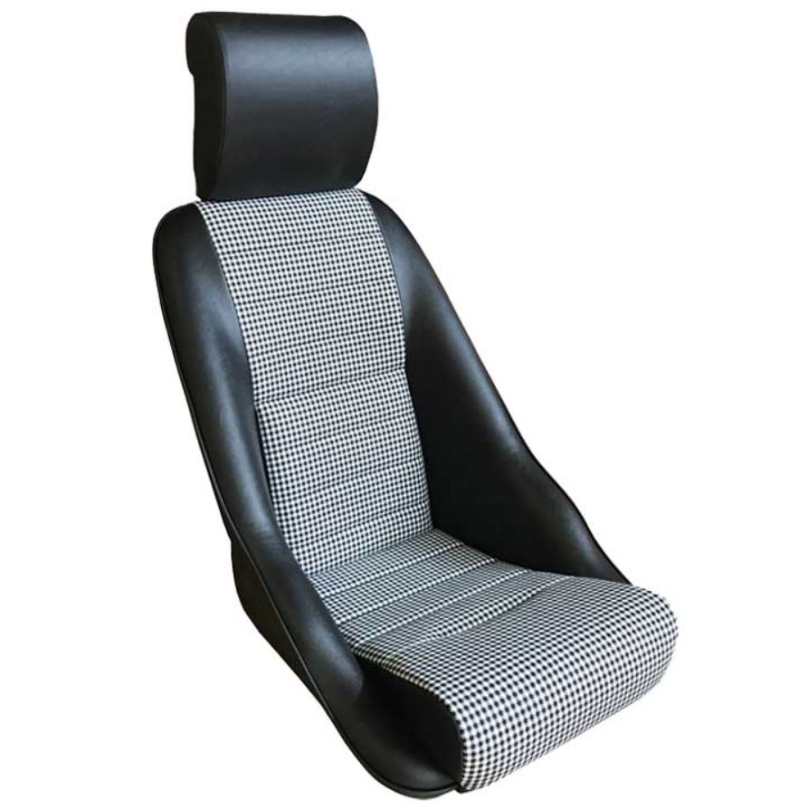

So kind of at a crossroads right now with the 6. Have just had the pans restored to original configuration and do not want to add holes back to the floor. Want to use the normal seat base arrangement for driver and fixed seat for passenger as per original in 1970. I don't take passengers on the track but may title and street the car on occasion. I don't mind having two sets of seats per se (one street one track) but definitely do not want to add back side mount and drill holes in the floor again.
Any advice from this fine collection of 914 gurus?

Like for steering wheels (I have 3 types), I plan on having a set of stock seat and I have these Type 14 from Classic Touring Seats. All using stock rails so they will be easy to swap around. (IMG:style_emoticons/default/driving.gif)
