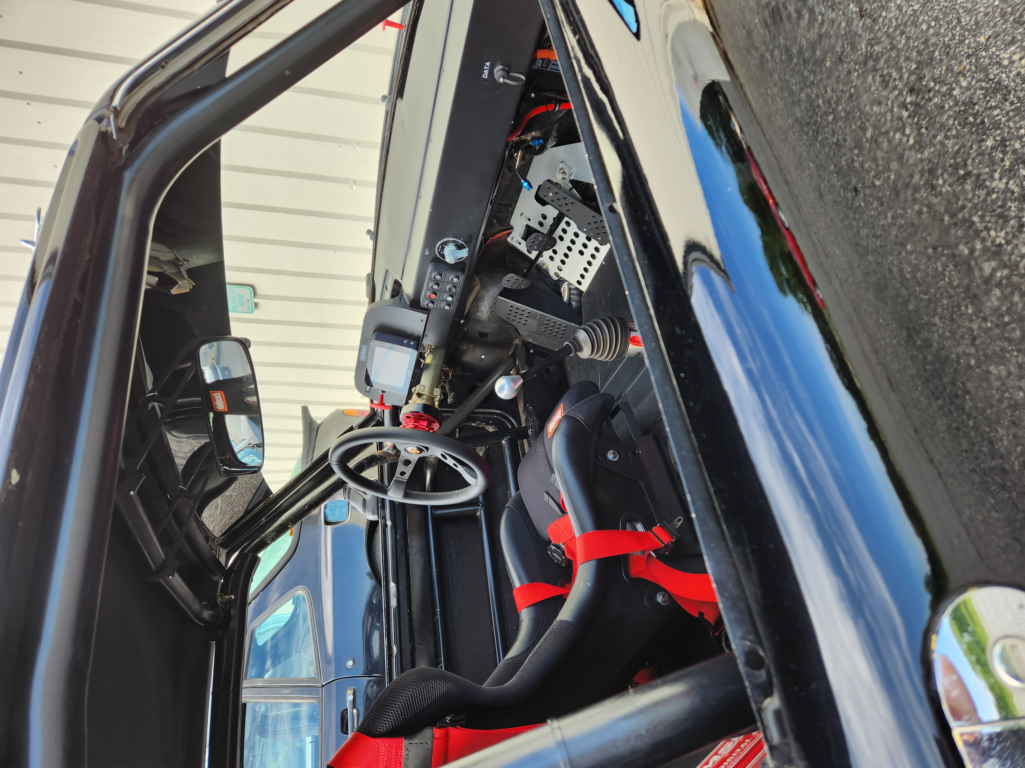

So kind of at a crossroads right now with the 6. Have just had the pans restored to original configuration and do not want to add holes back to the floor. Want to use the normal seat base arrangement for driver and fixed seat for passenger as per original in 1970. I don't take passengers on the track but may title and street the car on occasion. I don't mind having two sets of seats per se (one street one track) but definitely do not want to add back side mount and drill holes in the floor again.

Love pepita for sure. Would be so.great to.find a vintage looking fia seat. Checking the rules for HSR they state the strongly recommend fia, which to me is needed for them.given some.of the real high dollar exotics that have period seats. 914-6 is not exotic plus I like good safety equipment
My setup now:
