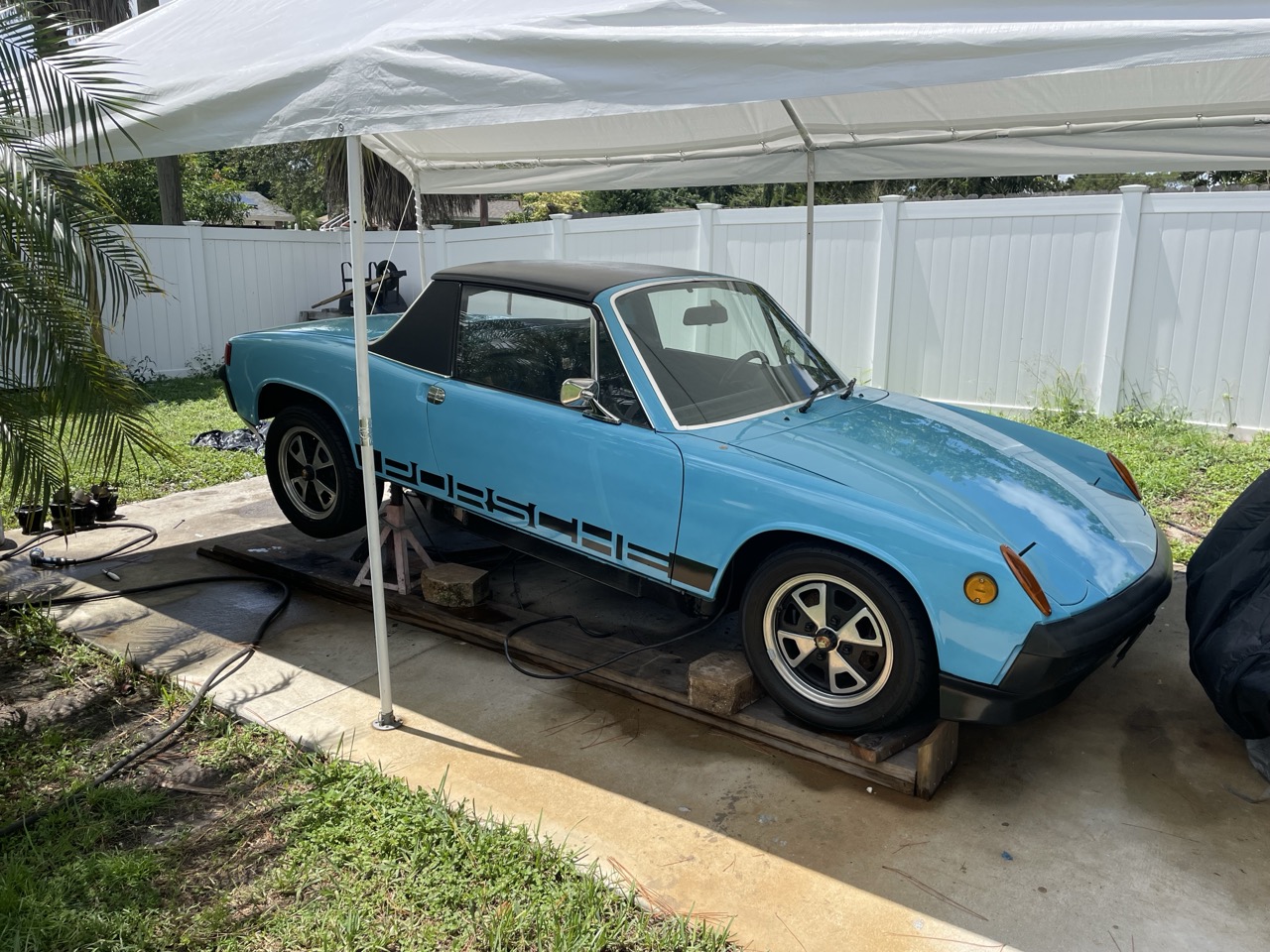

This is the 74 914 that it is going into…one of these days!
