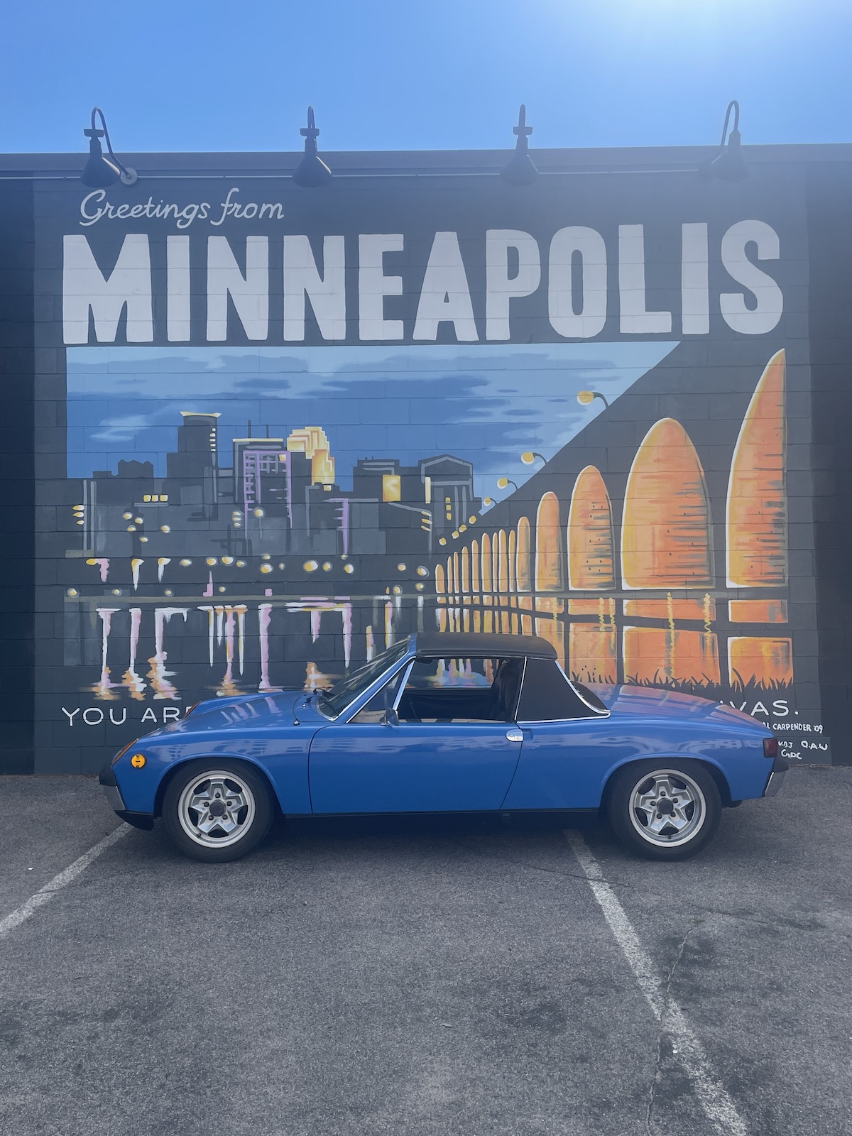

And a quick shot in front of the Minneapolis mural adjacent to my office. For a good week or two, before it got too hot here, I drove the 914 to work.

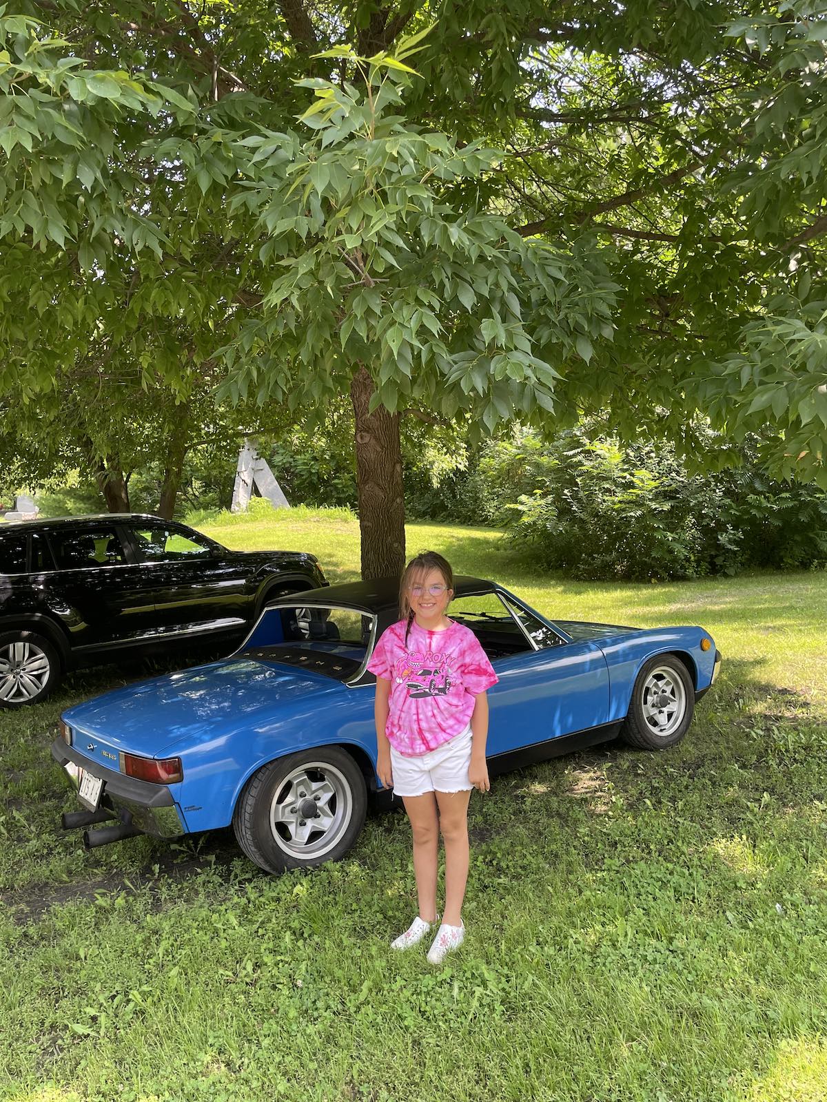

And another shot with my daughter during a trip to the local mini golf spot.

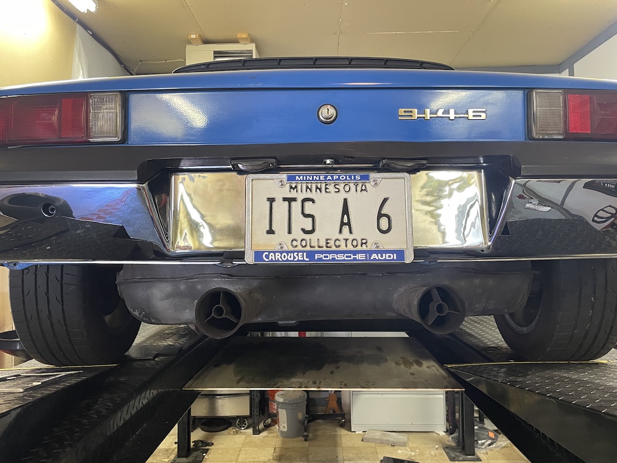

And finally, a shot at home on the lift. I was able to source this vintage license plate frame from Carousel Porsche/Audi. I find the frame cool for two reasons. First, my dad bough the 914 at this dealership in the mid-eighties and this is the frame that they probably would've put on the car at the time (or maybe a bit earlier). It's also cool for me as I spent 10 years working at this dealership, starting when I was 15 years old.
