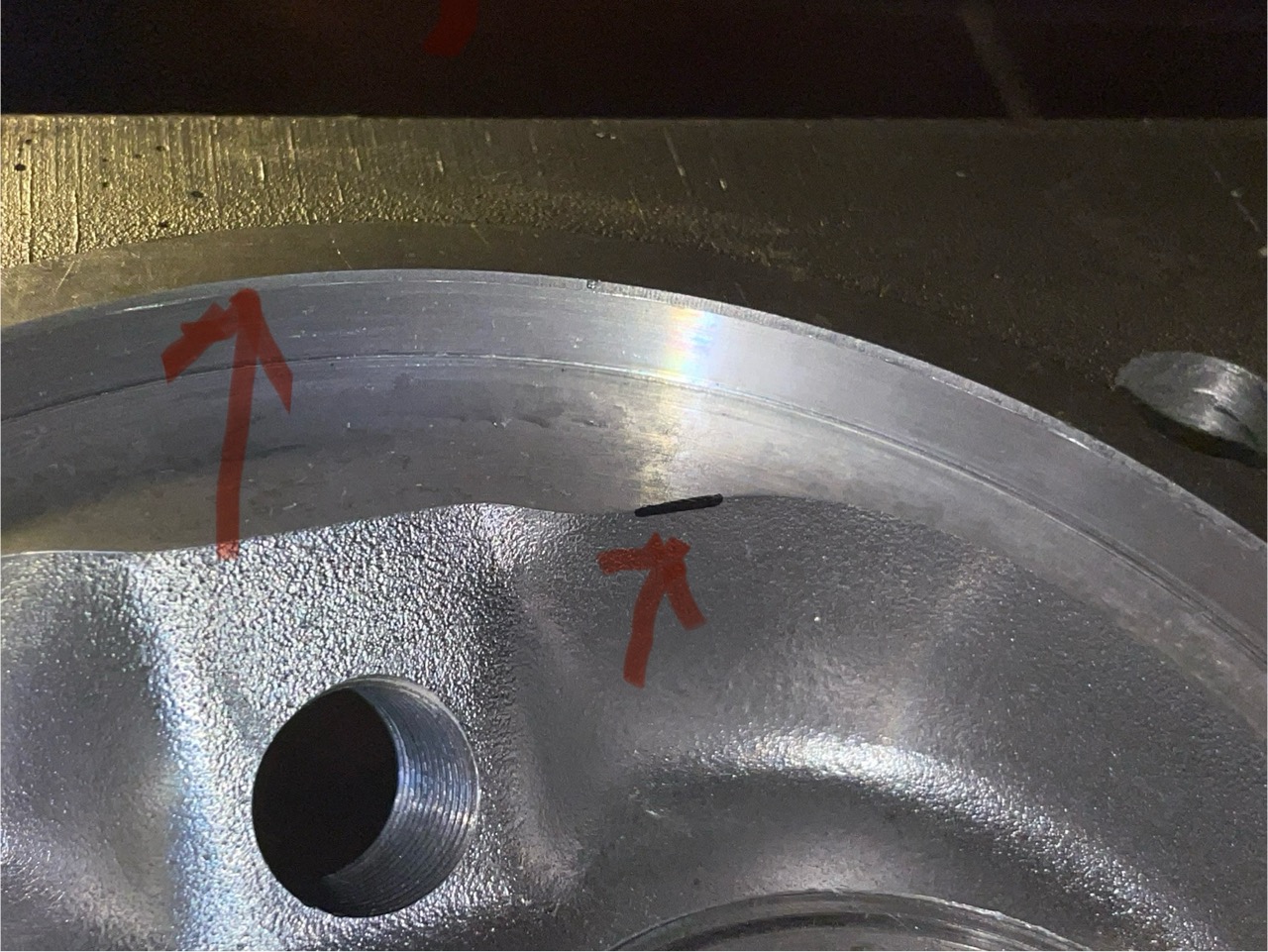

Question….
When I get my heads fly cut, it looks like I need to cut about .025 out to get to my target of 57cc’s total. Does this seem reasonable? 60cc heads with 3cc valve reliefs=63cc.
Take away 6cc from the heads looks to be about .025-.030 cut needed. When I looked at the head surface there is a raised outer circle of aluminum that will need to be milled as well so that it will mate with the head surface. Am I on the right track??
Flying up to Indianapolis in a couple days, taking the heads and the case with me to a shop up there that I know well. Spend Christmas with the family and get my machine work done at the same time! Kill two birds with one stone (IMG:style_emoticons/default/beerchug.gif)
Thanks again guys for the help….super appreciated!
The black line is the amount that needs removed.
The other red arrow is the raised aluminum area I was speaking of needing removed to let the cylinder mate with the surface of the head.

technicalninja   On a bone stock 73 2.0l the depression in the head...   Dec 18 2024, 10:50 PM
