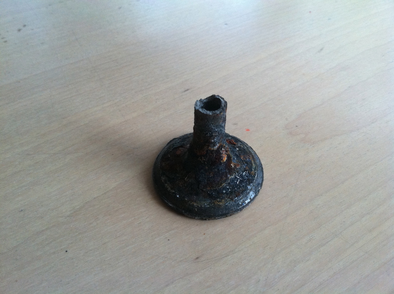

using 50 yr old sodium filled exhaust valves is VERY RISKY.
When rebuilding my 2L heads preparing to remove valves, i gently raped the valve heads just to see if any were frozen in the guides. One head popped right off (IMG:style_emoticons/default/WTF.gif) (IMG:style_emoticons/default/WTF.gif)

technicalninja   TLDR: Sodium filled valves are not inherently bad ...   Dec 18 2024, 10:04 PM
barefoot   TLDR: Sodium filled valves are not inherently bad...   Dec 19 2024, 09:35 AM
technicalninja   Barefoot, I'm in agreement! :agree: Than...   Dec 19 2024, 10:49 AM
VaccaRabite   I was not aware you could even GET sodium filled v...   Dec 20 2024, 08:19 AM
flipb   Inconel was created for spaceflight. I've got ...   Dec 20 2024, 10:42 AM
technicalninja   Inconel was created for spaceflight. I've got...   Dec 20 2024, 01:14 PM
