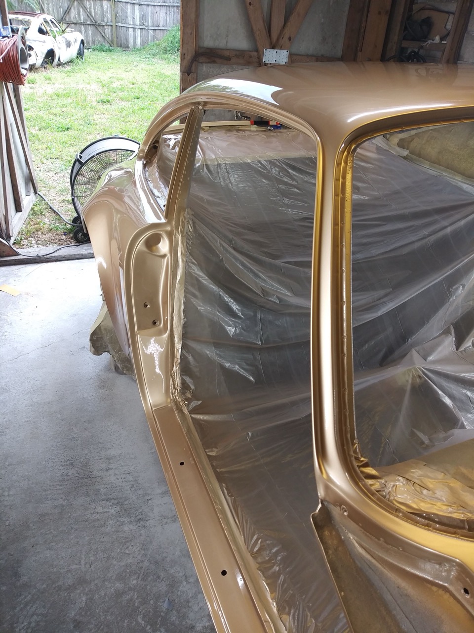

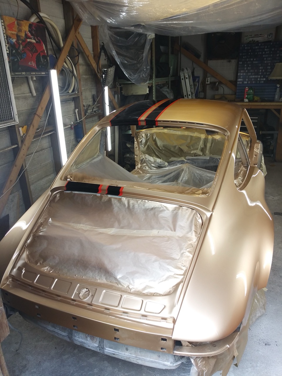

Now worries, no offense taken. Like I said I wouldn’t have even taken this one on if it wasn’t for the help of this site. I did the same thing when I built my LS1 in my C5 a few years back. I ended up with 470 rwhp on a naturally asp small block. I take all advice with a grain of salt, but without all the input I wouldn’t have attempted that either.
I do own a 1979 911sc imported from Germany by its only other owner. I’ve owned it for 23 years and just finished painting it last year. Haven’t put it back together yet because I always get distracted with a new project. Working on a 69 beetle right now as well that I adapted a 2.5l turbo forged STI engine into it. It has been a very challenging project getting the cooling and front end set up for a water motor.

technicalninja   The 911 is COOL! What's that white car in...   Dec 19 2024, 04:26 PM
Jack Standz   Chad, Awesome looking 911SC. You should be worki...   Dec 19 2024, 08:33 PM
Chad911sc   The 911sc is actually a Max Moritz built Porsche. ...   Dec 20 2024, 09:11 AM
technicalninja   Let's see here... 500 hp Vette Nice NICE NICE...   Dec 20 2024, 01:26 PM
